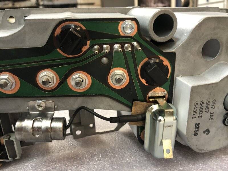

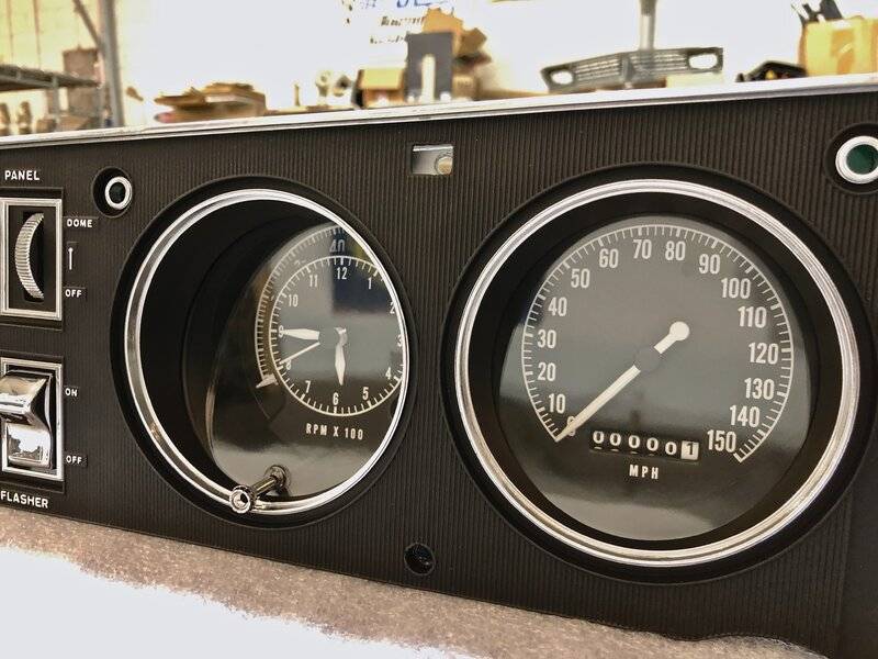

Very accurate if calibrated correctly and your systems are in good shape.

Very pretty restoration. :thumbsup:
In regards to the OP's question, the answer is - it depends.
There's not going to be a pat answer to such a generalized question, of course.
That said...
One thing to make sure of is whether or not the voltage limiter for the cluster is functioning properly.
If that thing is out of whack, several (but not all!) gauges won't read right - if at all.
They make a digital one and I recommend using it.

Steve817 - that looks amazing!! Love it!

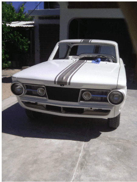

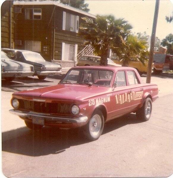

I like to run mechanical oil pressure gauges outside on the cowl. The Barracuda gauge still needs to be mounted. If you look closely, you can see the gauge on the cowl of the '65 Valiant four-door bracket racer I built.
