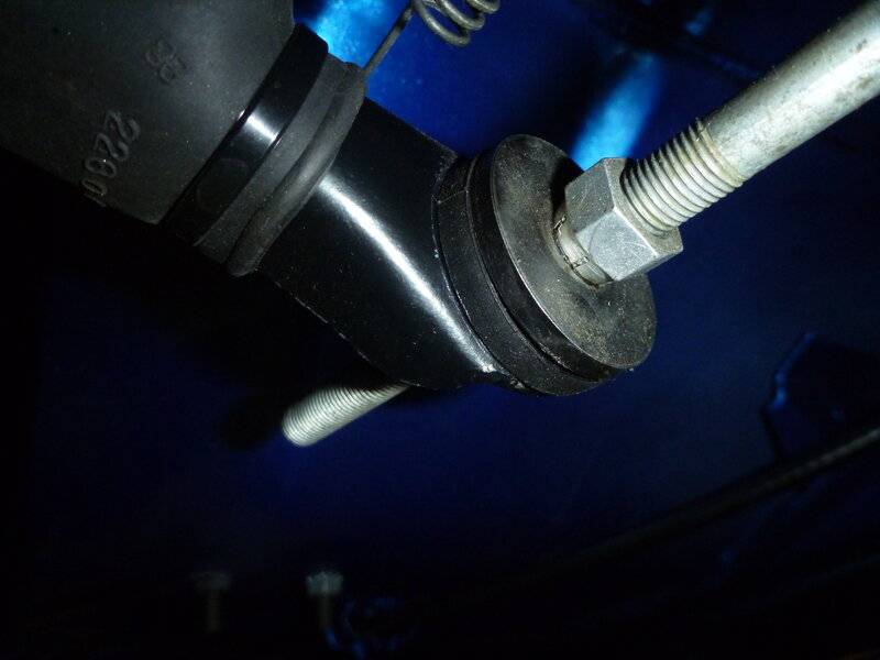

.........The kit only comes with one stop nut. Mine had 2 on the back side.
The kit should come with the "d" hole washer that dadsbee picture portrays. The washer ID has a taper that forces the the flex type nut to close up and lock the adjustment when peddle pressure is applied. Although one could use a second nut as a jam nut to lock the adjustment, there's no need real for a second nut using the functional stock parts.
