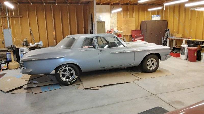

My ride is a little low in the rear so already tried QA1 shocks, didn't work and tried longer shackles, didn,t work. Any suggestions?

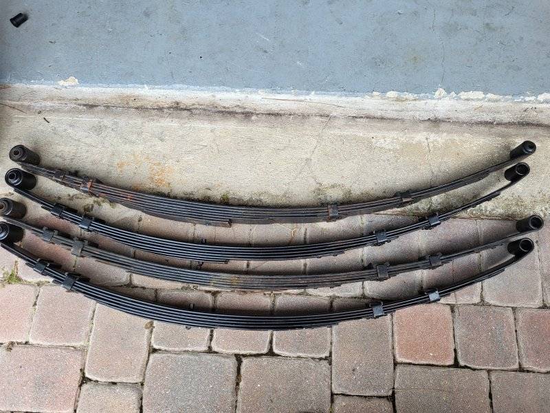

You can try ESPO Springs and Things. They make leafs with increased or decreased ride height +/- 1", 2" or I think up to 3" - not sure if they have them for a 64 Savoy. I just put a pair of +1" on my 67 Satellite. I am happy with the change
10 yr old Mopar Perf XHD springs
New ESPO 67 GTXspec +1"
Well I called Espo Springs and they cannot help me unless I can tell them what the factory ride height is, I searched for 3 hours yesterday and cannot fine that listed ANYWHERE. Any idea how you determined you needed a 1" lift and what was your final measurement on your height?

I wasn't able to find any rear height spec for my Satellite either - not sure they had any due to the variations available. I posted that question in the 66-67 forum and consensus was that there was no spec for the rear so the +1" was guess on my part based on how my car sat.

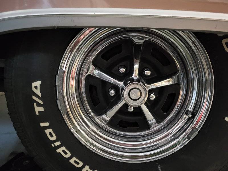

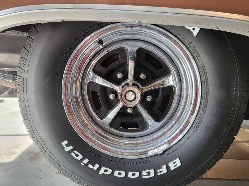

Others in the 66-67 forum were showing where the wheel/tire sat up relative to the wheel opening on their cars. Most showed the top of a 14" rim sitting about even with the opening. Mine sat deeper into the wheel well as seen in the pics above. I want the car to sit level or slightly high in the rear. With the previous springs, I had to lower the front well below spec to achieve that and then found that I was bottoming out the LCA on the bump stop. Took a gamble on the +1's, but they seem to have achieved what I wanted. However, I am still going through a front end rebuild including upgrading from 0.90" to 1.03" torsion bars so I don't yet know how it will sit when all 4 wheels on the ground.
Car is still up in the air while I finish the front. Rear is supported by the axle (weight on springs) so I can try to measure distances between the body/frame and axle. Let me know if there are specific measurements that would help.
Side note - I am unhappy with the durability of the Mopar Performance XHD springs. I put them on less than 10 yrs ago, less than 10k miles, to replace stock HD springs and was initially happy with the ride height, but they sagged quickly. This is a cruiser, not a high HP racer. The new springs have the same leaf counts with more arch. Hopefully they will hold up much better.
