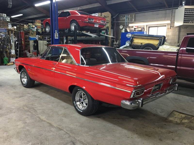

I just found a old spring with a little more ark and cut off the main leaf and added to my spring pack. That was fourty years ago. If you are determined it will happen.
That looks good and sets nice. My Swinger has an extra leaf added as well and it works pretty good. I would say it's an inch over stock.
