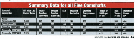

I talked with Dwayne Porter in 2022. He was sort of neutral about my possible jump to a roller. He thought I may not see a huge power increase over the Mopar 528 but did advise me to chat with other guys that went with a roller. Nobody seems to regret the move.
