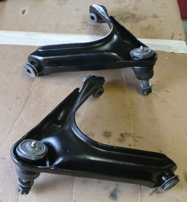

I am rebuilding the front end of my Roadrunner and am not sure how to change the upper control arm bushing, can any one give me some guidance? Thanks in advance!
You need to support the inside of the A arm around the bushing with a piece of tubing then press the other side. The tubing will allow the bushing a place to go.
On my 67, I removed the control arms, bought new bushings and took them to my go-to shop guy, he pressed out the old ones and pressed in the new ones.
The bushings are fairly cheap as you know. I didn't want to booger up my control arms beating on them with a 2 lb. hammer because I do not have a press.
It's not a big deal for a shop with a press and a guy that knows what he is doing. Good luck.

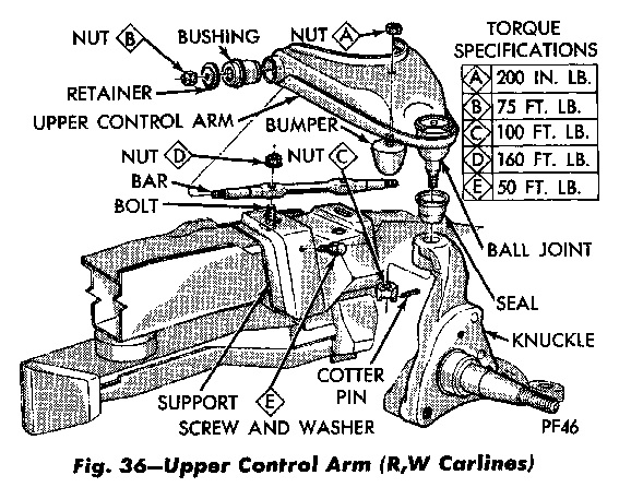

Thanks guys. The Roadrunner has a pivot bar in the middle of the bushings and I'm not sure how to get the bar out first. The manual says it is all replaced as a unit but I can get the bushings.
View attachment 203529View attachment 203530
When I did mine I:
-remove the nuts (B) from the bar
-remove the nuts (D) holding the bar to the support bolted to the Kframe
...now you have the control arm with the bar still in the bushings...
-Using a torch, burn out the rubber
...now the bar will come out
-press out the shells as previous posters describe
-press one new one in
-put cleaned up bar back in
-press second new bushing into arm but you need to find a way of supporting the control arm pr risk destroying it. I used thick walled hollow tubing cut full length down a side so that the bar would fit inside.... sorry hard to describe properly and I dont have it anymore to take a picture of. I'm sure I can draw it though if you cant picture it.

Weather delay so I had time to look at it today. All apart and just need cleaned up. Thanks again!

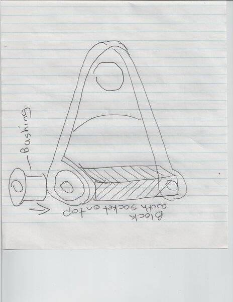

If you could doodle up a simple drawing of the tubing and where you put it, that would be highly appreciated!
This is how I did it.
I used a piece of 2x4 and shaved it down to fit. Then found a socket that would fit over the bushing and put that on top of the wood. You could use a piece of pipe if you have it but you still want it to fit over the bushing. Also make sure the fit of the wood or pipe is snug, you don't want to compress the control arm.

How did you manage to push in the second bushing with the lever bar installed?
Awesome, thanks!
I made a second piece of wood the full width of the opening (no socket) and placed it beside the bar while pushing in the bushing.
