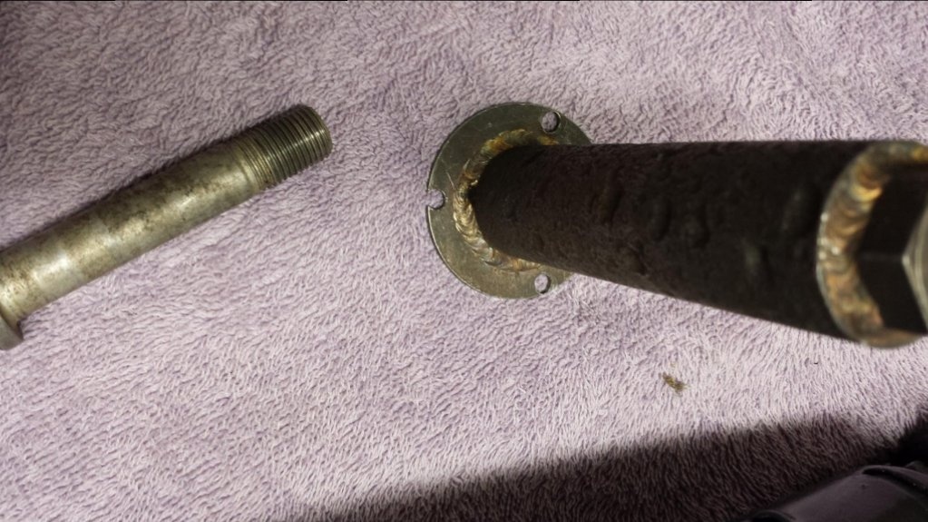

I'm going to try and remember to post pictures tomorrow of my homemade A body puller and a disassembled unit if you need it.
I've got one in pieces now.
Seems like that is what I used.
He's in Ireland so he may not have the same resources.

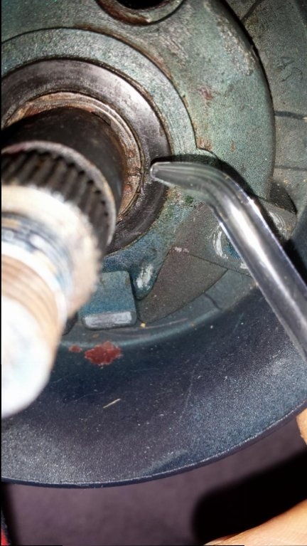

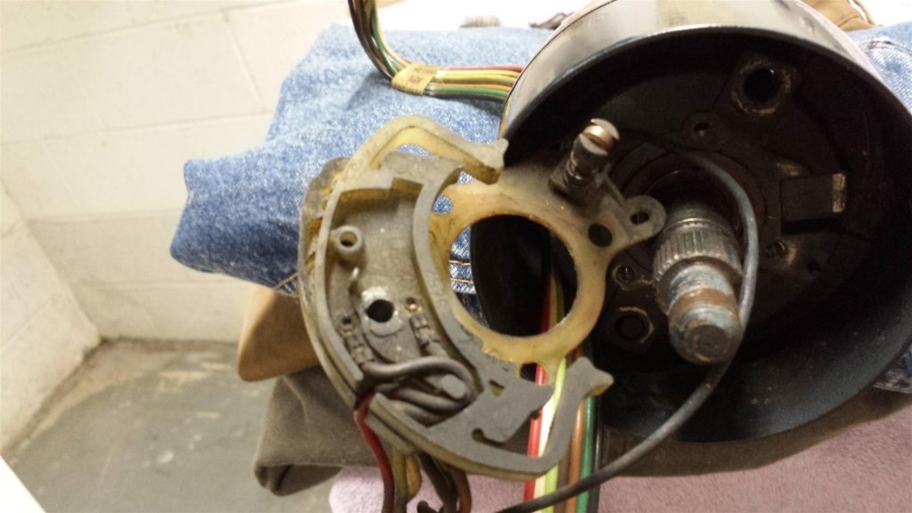

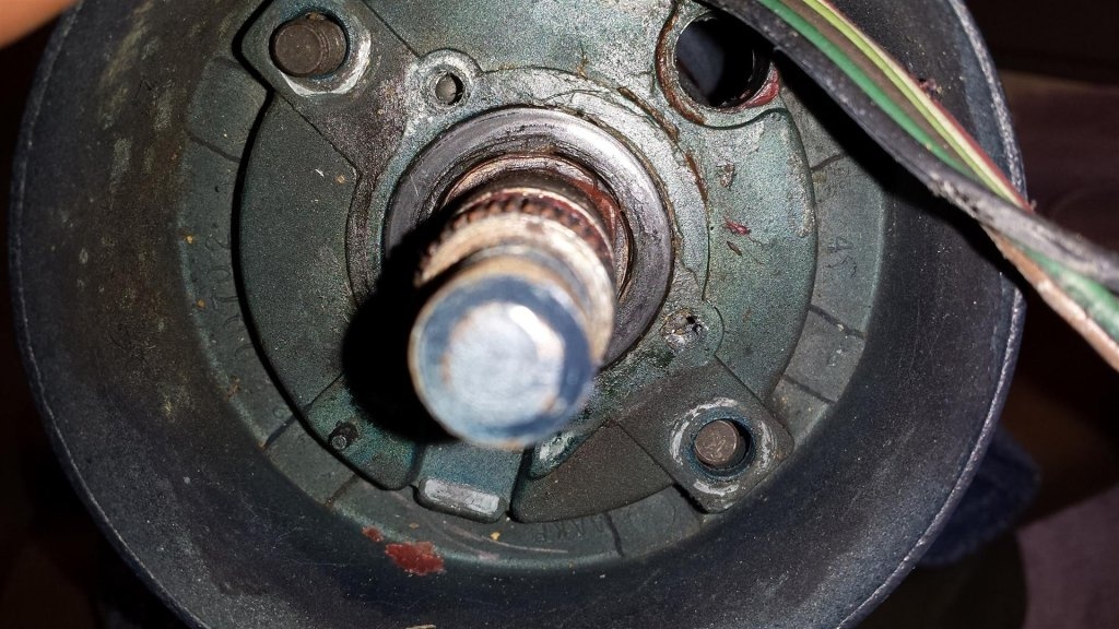

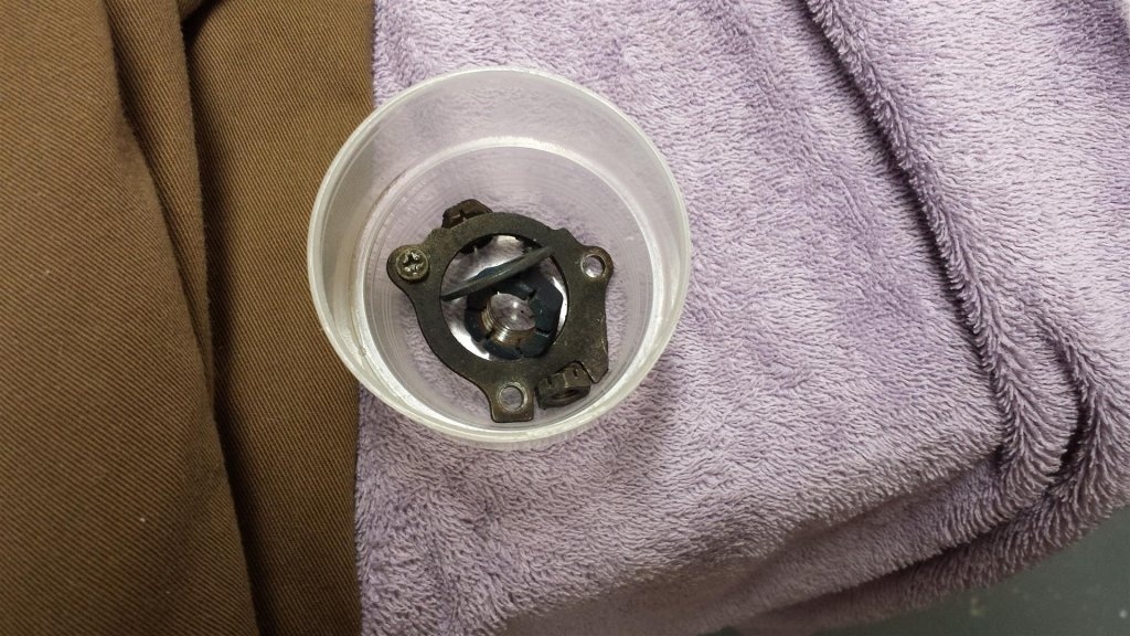

Sorry for the delay. Been swamped.
If you still need the information or for general use.
The steering wheel is already removed in this picture.
I'm in the process of removing the turn signal harness.
(The wire ribbon goes through the housing.)
Same principle. Use "bushing" to get the length needed. Sockets work.
Note the internal lock ring that must be taken off.
Same across car lines of the era.

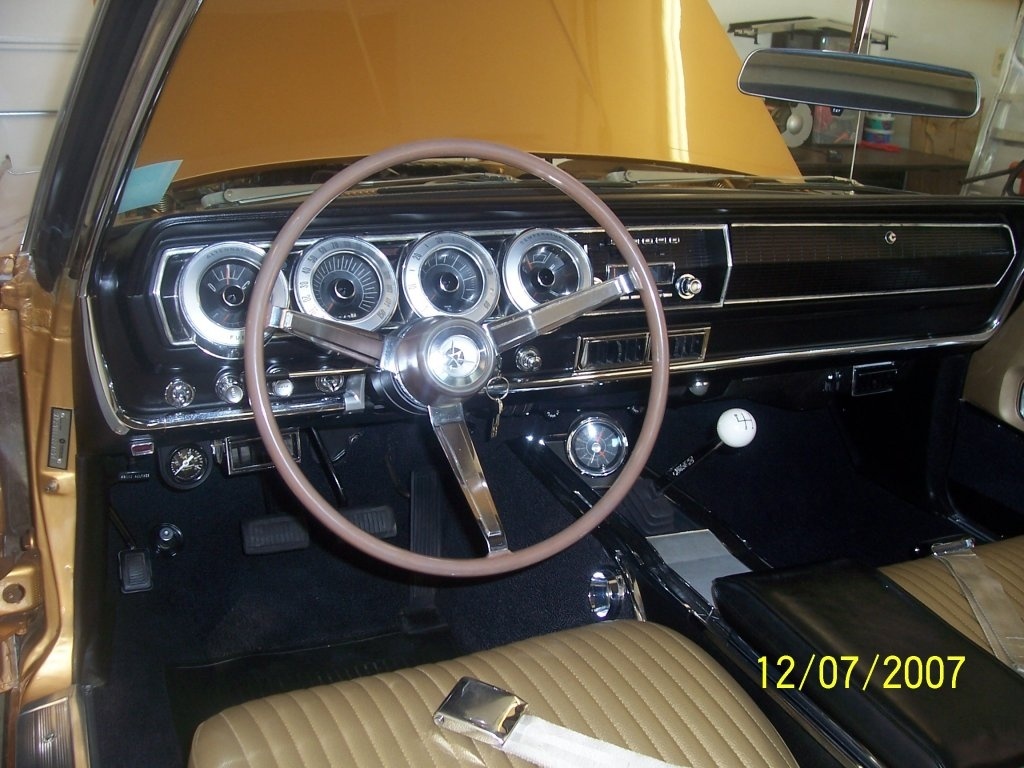

I just purchased a wooden rally style wheel from PG Classics for my '67 Charger. It's made in China but a big improvement from my cracked plastic wheel that's hiding under the leather wrap. But, my old semi-circular horn bar isn't going to work with the rally wheel. Do I need different retainers, or will what's there now work with the center mounted horn button? I'm striving for the look that Alextucker has with the chromed center button. I see padded vinyl buttons, but prefer the chrome look as pictured in the original post of this thread. Any information on parts needed and where to get them, would be much appreciated.
I think that Alex has the deep padded horn center. I don’t know if it would work, but you might be able to get the retainer from a regular 67 b body wheel, and horn center. I should have retainers, but the snow is about 2 feet deep in places to get to them.
