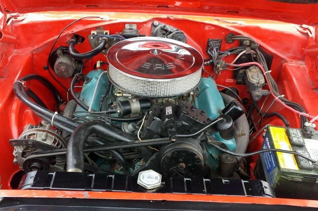

Hey all. I want to use this car as a guide for things for me to look out for. The seller claims it's a 440 but someone has pointed out the engine is painted the wrong color. Were 440's ever painted turquoise at the factory in 67/68? Would it be turquoise b/c it had ac due to lower HP? For a 383 I've learned some were painted turquoise if it had ac due to lower HP and a milder cam. If the car was non-ac then it would be orange to show it was higher HP.

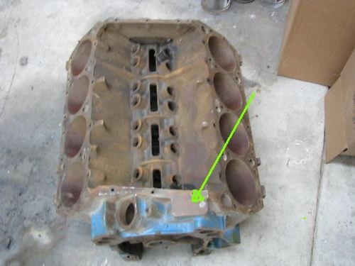

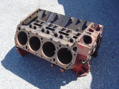

Here's pictures of a 440 block and 383 block. As stated above, the telltale sign of a 440 block over a 383 is the ID block on the 440 motor (see arrow pointing). The 383 does not have a pad in the same area. The casting numbers also verify it.

So in this case, the seller is claiming that it has a 440, but it's painted turquoise which is the wrong color for Plymouth and Dodge 440's. So without being able to see the engine block to verify he may be actually selling a 383 but claiming a 440.
I would think that in your example, on that condition of car, that he should know what he is selling.
If in doubt, I'd ask for a pick of the engine ID pad.
Thanks guys! He's a re-seller so based on his email the # I believe he is referring to is actually the intake manifold # used on a 440 & NOT the block So in the end what we have here is a 1967 intake manifold on a 440-4 engine painted Turquoise which is the correct color, assuming the ID pad is stamped in the correct location to ID this as being a RB.
