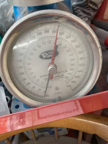

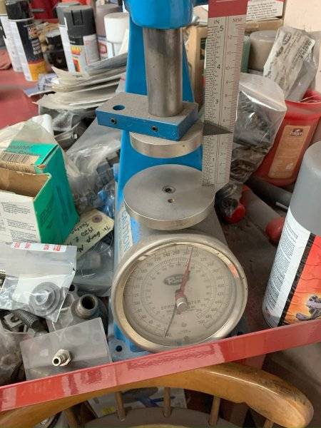

I'm contemplating a switch to a roller cam in my car and I've wondered about the springs.
How does one determine if a valve spring is still good and what the rate of it is?

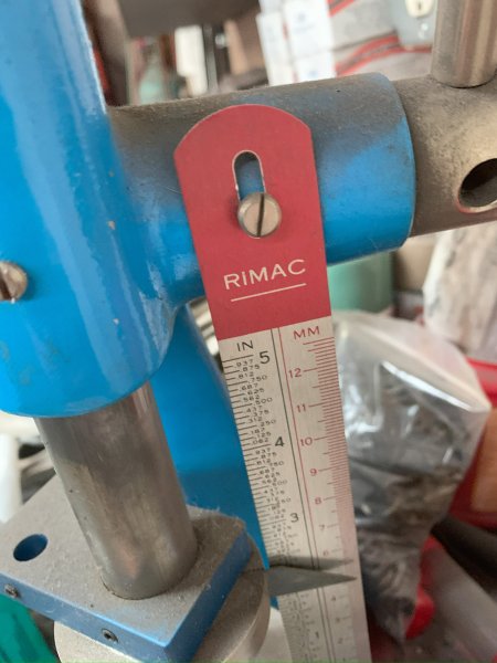

Is this spring checker something that a machine shop usually has?
