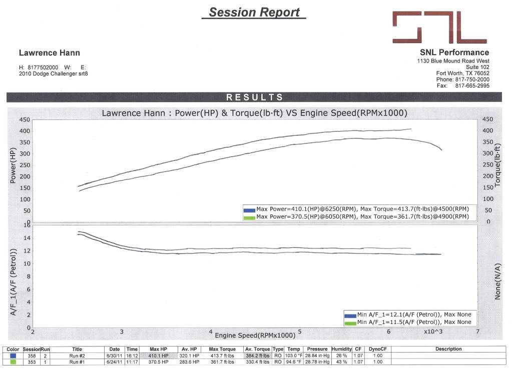

You should become a gold member and take advantage of our specials. We have a heads and cam package that adds 80-85 wheel horsepower and torque with a stock idle, 2-3 mpg improvement on the highway, and no loss of mileage due to idle. You won't know there is a cam in there by listening to it.

80-85 rwhp? Are those real numbers ?
And add 2/3 mpg? I gotta see that!
What are the specs for the cam you recommend ?
And what are done to the heads?
Do you port the intake?
What exhaust? Long tube or shorty headers?
I have no doubt cam and heads increase power but I gotta see it with my eyes,
When I was younger every vendor claims big power until its installed then your on your own.

we pickup 40/50 alone from the cam I am telling you about. That is on a STOCK 6.1 with stock exhaust and airbox. What was the DA on your runs? What does your car weigh? There is probably 1-2 tenths in your 60ft with the right setup. 107.7 is a really low MPH for a car that should be considerably lighter than an LX. I would say you are loosing a lot through the drivetrain. You could benefit from a dyno tune.

What Dyno are you using?
Mustang dynos compared to others show different numbers.
