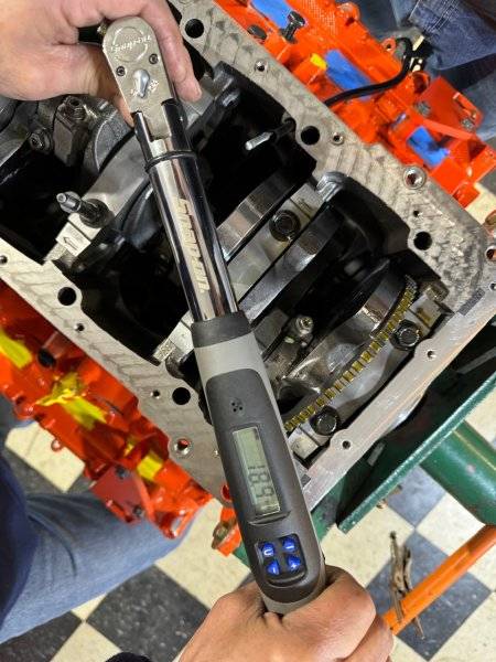

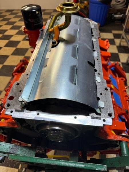

Installed Holley Mid Sump Oil Pan
Requires New Cap studs / bolts torqued by angle of rotation

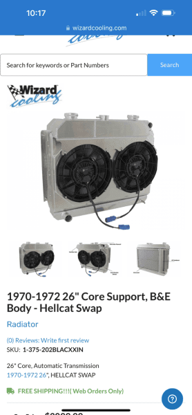

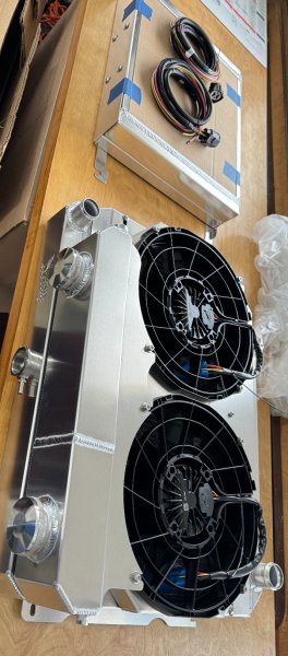

I figured Id spend the extra $ and buy a Wizard Rad … Its proven and fits right out of box …

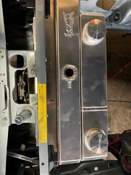

Radiator looks great
Looks kinda fat .
Im sure itll fit a long nose charger
Not so sure a Plymouth.
It dont fit.
3 phone calls to Wizard
One reply - spacer bushing the radiator closer to engine so intercooler and AC condenser might fit . wTF

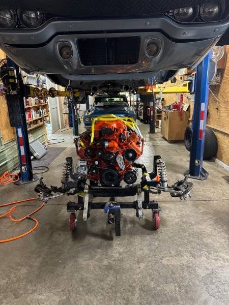

I installed the engine onto my RMS kframe . That fit .
Set the car ontop of the kframe .
3 speed wiper motor interferes..
wtf - i verified the spacing between rad support and engine - There might be an inch to spare .

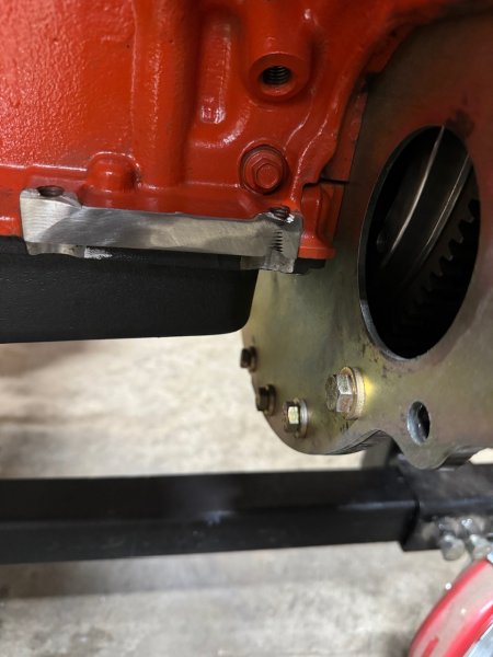

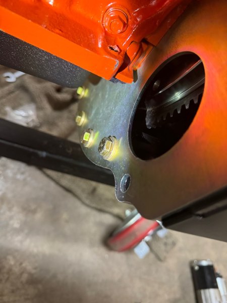

Then I tried to put starter in .
It wont fit .
Hellcat swap on FB said all you need to do is trim/ grind a little bit ..
yeh right ..
Im still chewing on steel powder .

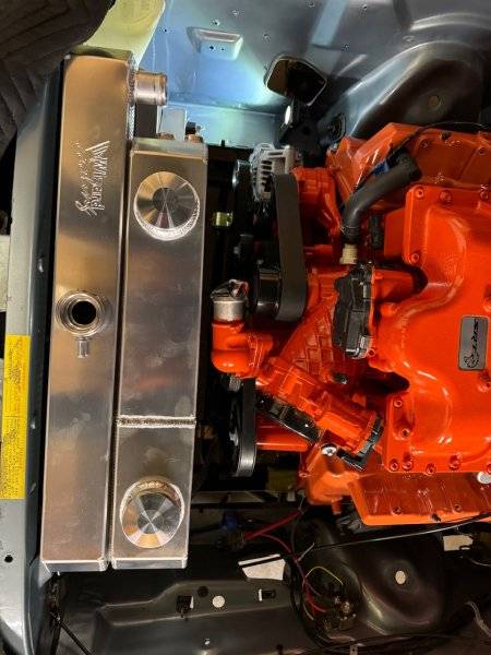

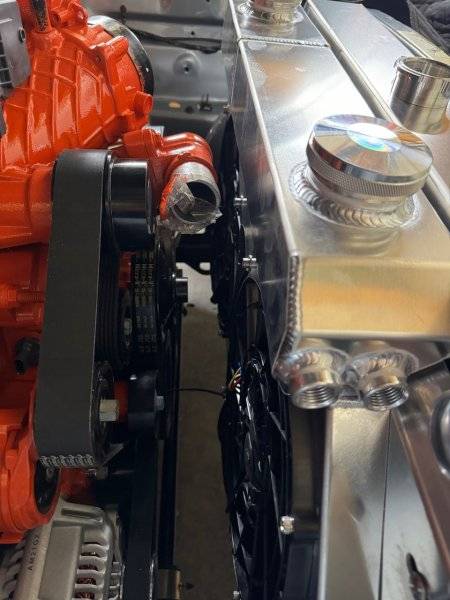

I started looking at wizard rad trying to see if I can actually fit it .
This time I planned engine in place with main rad, fans , etc .
Researched conversion from 3 speed wiper to
2 speed , more fun .
Pulled wipe motor .
Mocked up intercooler and condenser
Looked for hardware to set it back towards engine compartment. It might work.
It might look goofey ,
But itll save me another $1000 bucks and a month of lead time .

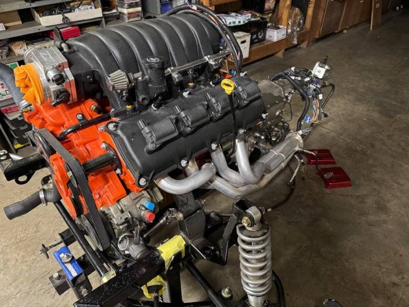

I set the engine in with tranny .
Pretty smooth.
Engine cleared 2 speedwiper motor
And I have 1 1/2 inches clearance between
Thermostat housing and fans .

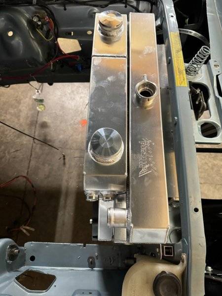

I spent the weekend setting the lizard rad back 3/4” not so happy with result
But it might work
How was this cooling system not fitting? Was the intercooler and AC condenser too thick and hitting something forward of the radiator support??
Yes the hood latch support gives me 3” from core support -
The wizard is almost 4”
