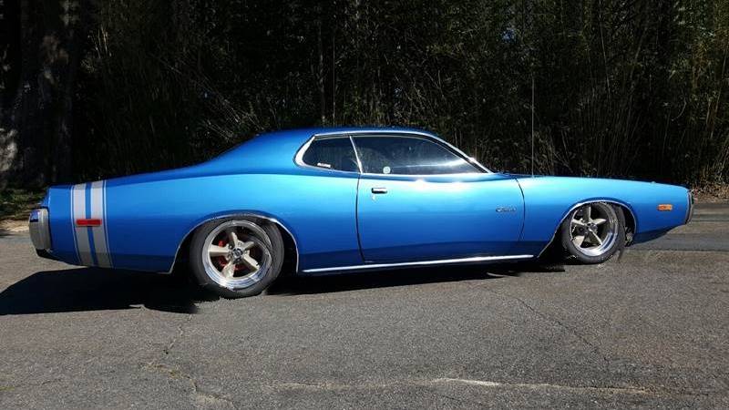

So, the charger is finally coming home with me. I've got a lot of respect for the guys keeping it true to original and respect for the drag racing community. It's just not me. I want to have more of an autocross look to the old '73. I would like to see the rear wheels up in the wheel wells and for it to have, more of a flat look. I'm not trying to go crazy because I don't want the car to be so uncomfortable that it is no fun to drive but, I would like for it to sit low. My question is 'How low can I go without changing to a 4 link in the rear or bagging it? I don't have the money for that just yet and honestly I really want to drive it soon. Would you use lowering blocks? Do I need to tub or mini tub the rear end to get a 17" or so wheel/tire combo sitting up in the wheel wells? Will it be necessary to get drop spindles for the front or will I be able to adjust the torsion bars enough to get the look I am hoping for? Any help from the highly Mopar educated people here would be most appreciated. I am not a photoshop pro and this is definately someone else's car but, this is kinda the look I am going for.

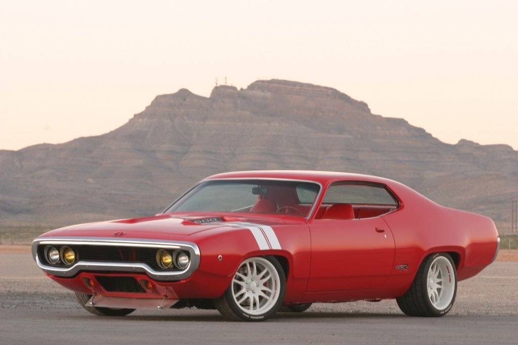

When we did this car years ago we ran 275/35/18 front and 295/30/18 rear (Viper spec) Hemi torsion bars and custom Eaton Detroit rear springs, mini tub Mopar spring relocation kit.Homemade subframe connectors.Also Hotchkis front and rear sway bars.Now you can get everything from Hotchkis.

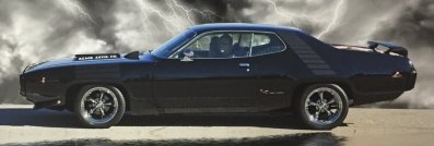

flatter leafs and/or hangers plus drop spindles for the win. My 72 sits about as low as it can reasonably get without those mods though. I like a little rake with mine. I think it keeps a hint of the old school.

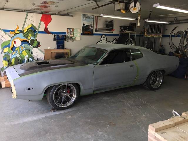

Im sitting on 4" drop spindles up front and a custom 4-link out back. Forgeline 19x9 fronts and 20x12 rears. I wouldnt mind going lower, but bags would almost surely be required. The Milodon pan is just 3" from the concrete currently haha. sorry guys i know its not a very good pic
Good enough for me !
