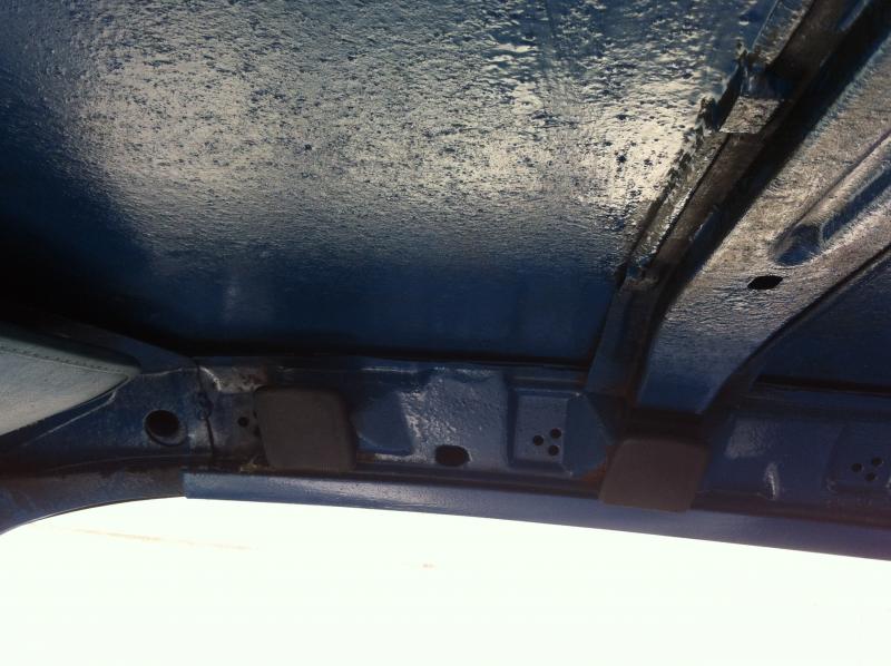

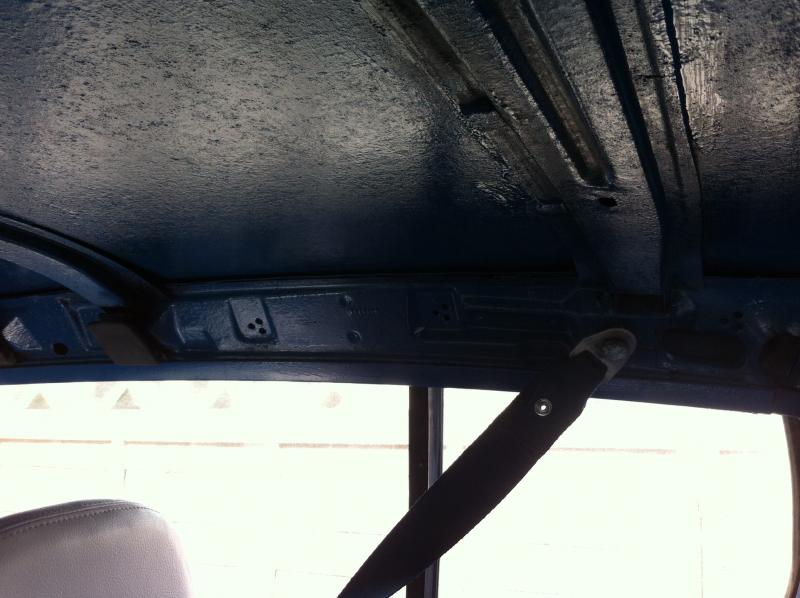

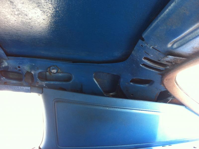

Thanks, just before I order am I right in. Thinking the bows connect into a set of triangular holes in the roof? If so, I definitely have the facility for more than 4 bows.
However, if I order 6 bows and a 4 bow headliner I presume I can still fit it by discarding the un required extra bows.
Just need to be sure before I have these parts shipped back to the UK at some expense.
I think I have my answer. All 73 cars are 4 bows but have the facility for 6!
yeap, facility is because they began getting 6 bows by 71/72 ( Chargers just 71s )... since roof frame remain the same all along the years, they kept the same 6 bows setup on body, BUT just used 4 of them

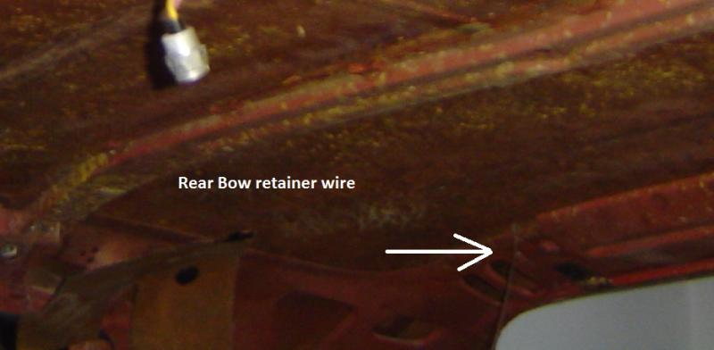

Don't forget, you will also need the two retaining wires that hold the rear bow in place.
Thanks guys. I'm getting my parts from Dante and he implied that the bows don't need retainers. Are those retainer wires something I could fabricate if needs be?
my 74 has a 4 bow , no side retainers , two rear wire bow retainers , I would suggest you use them for ease of installation. work your way rear bow to front, then side to side. test fit your bows to leave about an 1/8 - 1/4 inch gap between them and the roof for insulation.
