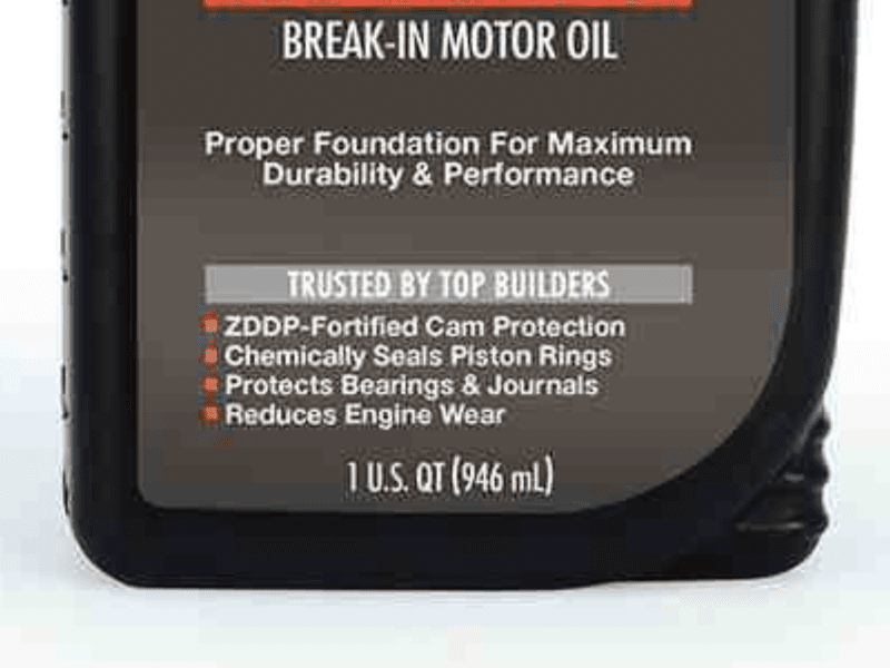

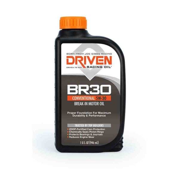

J Gibbs Driven BR30 Break In oil (regardless of it's Zinc & Zddp content ) has probably the Lowest Functional Anti-Friction wear protection package of Any commonly available motor oil & Least camshaft--Flat Tappet friction wear protection.....It's Lowest wear protection rating Will likely permit any new parts fit dimensional irregularities be most agressively self-clearanced wear mated in of all available motor oils & Least protective of Camshaft--Flat Lifter wear....If that's what you're looking for on first start up,... that's the oil (best friction in a can) product to use...

With the Gibbs BR30 BI Oil coming in at #278 of 278 motor oils tested on a flat tappet/camshaft wear simulator,....Why Use it at all ?? .....For a flat tappet engine , A good non--synthetic, conventional motor oil like VR1 10W30, testing much better on the Flat Tappet Wear Test
Simulator would seem a considerably better choice Break-In & regular using oil choice
this is why we buy a break in oil anyway, so you don’t have to mix and match stuff that may not mix well together.
When you mix conventional oil and a bottle of you favorite ZDDP, the high detergent in the oil fights the additives and it cannot do what it tells you it will do.
buy the right oil to begin with.
you wanna try and be a chemist with a new engine? Not me. I’ll trust the oil manyfacturer.
