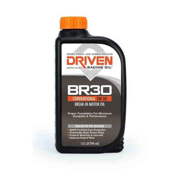

70rcode
6:30 PM
Jun 28, 2017
328
93
Usa
J Gibbs Driven BR30 Break In oil (regardless of it's Zinc & Zddp content ) has probably the Lowest Functional Anti-Friction wear protection package of Any commonly available motor oil & Least camshaft--Flat Tappet friction wear protection.....It's Lowest wear protection rating Will likely permit any new parts fit dimensional irregularities be most agressively self-clearanced wear mated in of all available motor oils & Least protective of Camshaft--Flat Lifter wear....If that's what you're looking for on first start up,... that's the oil (best friction in a can) product to use...
