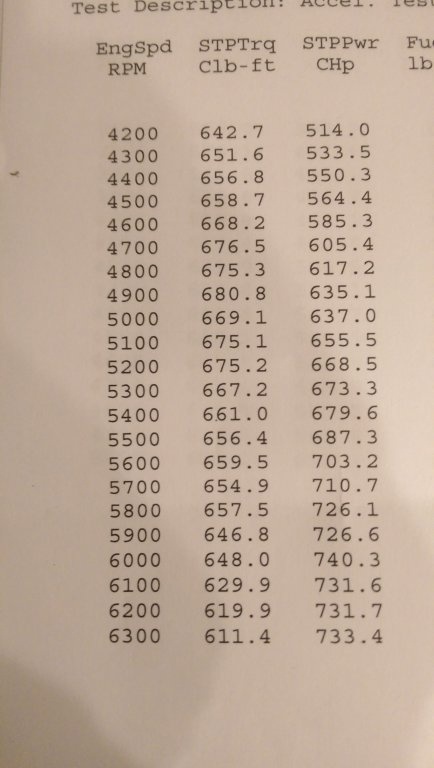

Update. Took longer than expected to get it to the dyno. Changed the intake to an Indy tunnel ram and the Fitech dual quad power adder setup. Final:
733HP and 675TQ
It was a good day! :)
Great job! Did you stop the pulls at 6300 or was power falling off after that?
We stopped at 6300. There might have been a little left, but it's a pretty mild cam so I don't think it was much. I didn't expect it to top 700.
The cam is very mild given the top end on it. A cam change and that mild mannered mill puts on a supermill cape! Nice job.

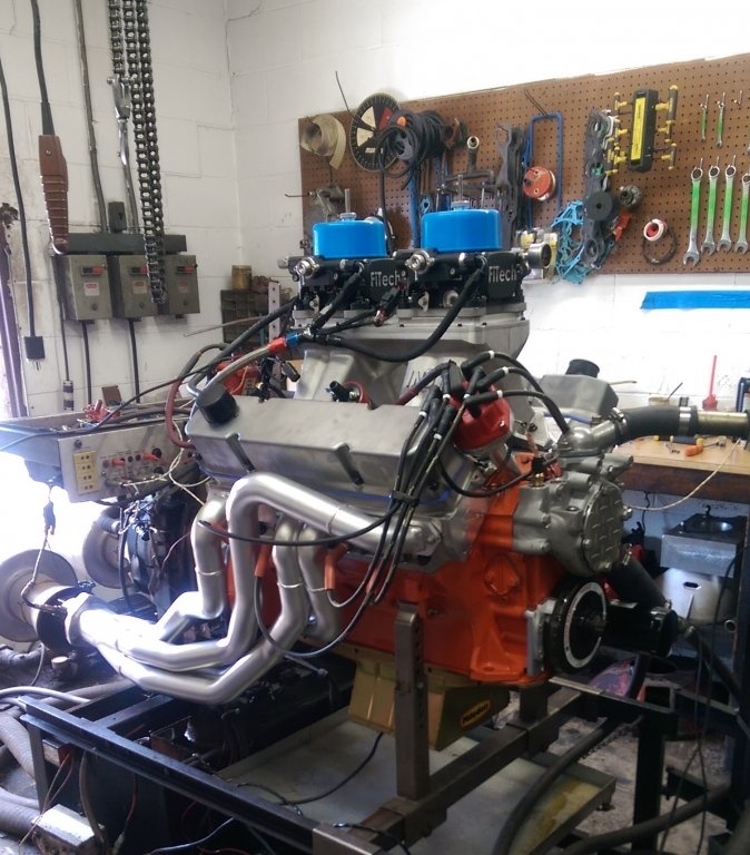

Thats great numbers for the combo ! What car is it going in ? Ron
And where are the pics of this beast so we can look upon it with envy?
