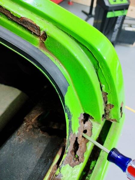

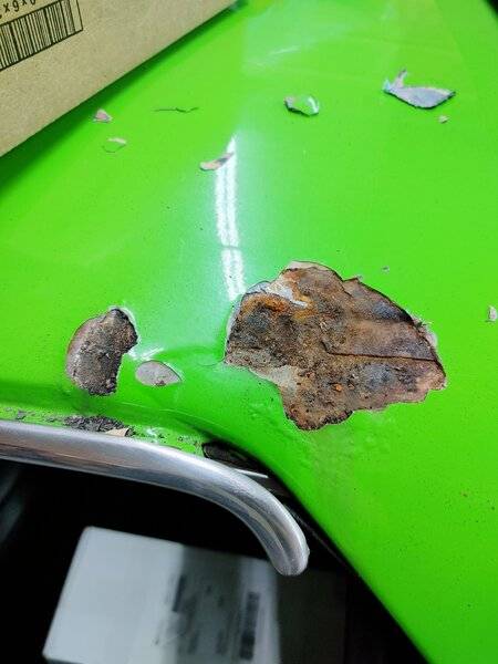

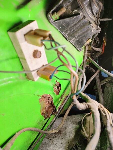

Many here have offered viable processesI'm afraid around every turn theres more rust. So far thats been mostly untrue, except a few of the "typical" spots. At least I gather they're typical from lurking around here. So far I've found some quarter rust, need to rebuild a corner including the trunk gutter. But some things like the rockers appear to be rick solid as are the floors. Meanwhile I need to do some cowl surgery! Going to pull the ending and start teardown real soon - build thread to follow. Gotta finish my up my shop build first so I can almost be organized.

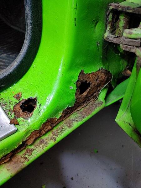

Most of what I need I've ordered patches for or found someone to help me get, but now I have a question about a new spot. After walking around with a screw driver and jamming it in spots that looked fun, I've found a new spot right in front of the passenger door. Looking for a little help on how to attack this. Disclaimer, Never done body work or rust repair before, learning to weld real soon. Looking for some thoughts and advice. Pictures included!
Been stabbing away!
Did this use to fill this with lead?
Cowl needs a little help, but parts are coming, thanks barnfind
an/or solutions as to how to tackle the
rust problem you're faced with.
I've been through this twice. On a Jeep that
frequented Texas beaches and an 80 year
old pickup that sat in the dirt for 30 years.
To truly get the "in your face" picture of
what you're dealing with, every single part
attached to the body must be removed.
The sheet metal has to be blasted. You
can do this yourself using a $50.00
blasting tank from Harbor Freight, some
blasting media, and a compressor.
We started with this;
and finished with this:
Blasting gives you a clean canvas where all
problems become apparent, it cleans the
surfaces of any contamination, and roughs
it up enough to accept lighter coats of filler
where needed. Any seams created using
repair patches or panels have cleaner welds.
This Jeep was in pretty bad shape. Sorry I
don't have any before pics. But with the
blasting and panel replacement, she turned
out pretty good. This is a recent pic, and I did
the body work 25 years ago.
Just my .02, but you're going to put all this
time and effort into your build, do it right
the first time, or you'll be doing it again in
short order.
