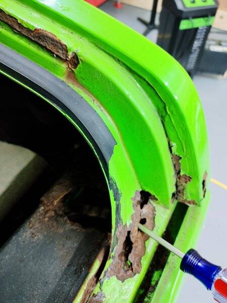

I'm afraid around every turn theres more rust. So far thats been mostly untrue, except a few of the "typical" spots. At least I gather they're typical from lurking around here. So far I've found some quarter rust, need to rebuild a corner including the trunk gutter. But some things like the rockers appear to be rick solid as are the floors. Meanwhile I need to do some cowl surgery! Going to pull the ending and start teardown real soon - build thread to follow. Gotta finish my up my shop build first so I can almost be organized.

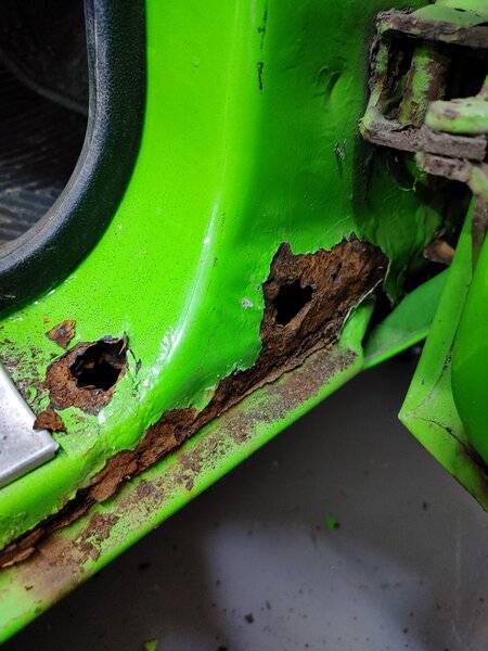

Most of what I need I've ordered patches for or found someone to help me get, but now I have a question about a new spot. After walking around with a screw driver and jamming it in spots that looked fun, I've found a new spot right in front of the passenger door. Looking for a little help on how to attack this. Disclaimer, Never done body work or rust repair before, learning to weld real soon. Looking for some thoughts and advice. Pictures included!
Been stabbing away!
Did this use to fill this with lead?
Cowl needs a little help, but parts are coming, thanks barnfind

Remember my quote, after half a century in the auto business: "where there's rust... there's more". The basic plan of attack is to remove the corroded parts while leaving as much original metal as possible. Another point: dismantle and disassemble to assess the FULL extent of restoration required BEFORE going to the next step. "KNOW" what you have to do, before doing it.

Is fixing that pillar something I want to find a donor for? or would it be something you'd try to construct with fresh metal?
Yes it was originally filled with lead. You now need to remove the lead until you have good metal all around that rust. Try not to dig too much into the drip rail if you can help it.
In regard to the front door pillar, that can be a bugger to fix. I would remove the fender, unbolt the door, remove the paint in the suspect area, and look at what good metal is left. A lot of time rust can look much worse that it is because it expands so much. Sad to say, in this case, it may be as bad as it looks. With door and sill plate out of the way remove the paint to see how far back the rust actually goes. If there is no structure left under that hinge/hinge plate area you might have to get a donor section. If there is still some support left you might get away with some patch work. Not light duty metal (24,22,20, or 18) least I would use is 16 but could bump to 14 for the section right below the hinge (14 is a bit tough to bend and can be harder to find). You can't do too much til you strip off the paint.

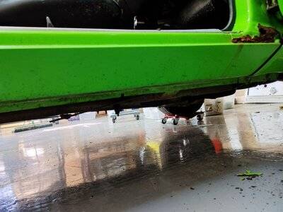

This is the rocker right under the rusted pillar, put the scope in for a second before I had to run, and it looked ok inside, will post more -
