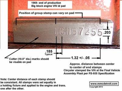

For the Super Bee, is the “0G######” the VIN or stamped near the radiator?
Just making sure I understand.
Thank you.
It’s essentially the business end of the VIN. I’ve seen the whole thing stamped on engine and tranny (not always) just the tail end on the body.

Oh, so these numbers/letters are in the VIN and stamped around the car. Radiator support, transmission case, block, I think the trunk deck too.

Yes, that’s the idea. If you go ‘68 or earlier ask again, similar idea in some areas, different in others. Vin will be similar back to ‘66, stamped numbers different.

Good info & mostly spot on.... The one point...
“0G######” should be stamped
For whatever reason Mopar transposed the first two so instead of 0G it'll be G0...
This hasn’t been my experience. Seems like a possibility though.
