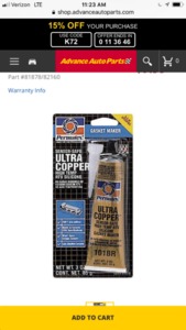

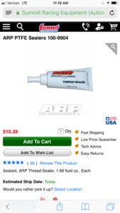

For the studs going into the heads use arp thread sealer which is definitely not the same as RTV
If you want a good seal at the heads use the copper gasket maker LIGHTLY to the manifold and just draw the manifold to the head do not crank down on the nuts just snug let them sit overnight to cure and then torque to final spec I don’t have the figure handy but around 11-13 ft lbs comes to mind but double check that.

E3366FCE-10F7-4958-9F01-496950663CB3.png D55264ED-0437-49BD-BD67-A8A9DE99DA51.png
Interesting this says for small block. Aren't we talking about a big block here? Or does it apply to both?
I just ordered some. They should fit as the studs are the same size. I'll check them on the fit when they get here and let you know. These just came out this spring, I'm surprised they dont list them for the big blocks. Worked at a dealer in the seventies, don't think I lost my memory just yet.
