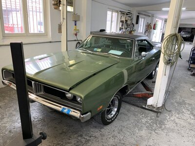

My charger is in the shop right now getting made ready to be registered in germany.
They do everything from regular service to complete restaurations.

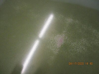

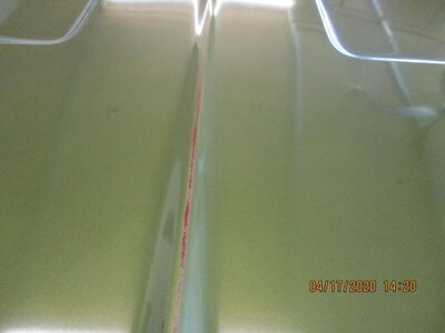

Well my car has some paint issues like surface rust on the hood, passenger side door paint slightly off and
smaller spots around the car.
I want to keep the original paint and just correct it to a level where the average joe on the street wont notice imperfections.
They told me its an old paint with different indegrients than modern day paint.
According to them you cant mix modern day paint with the old original one if you want good results.
If i wanted a good result i would either have to source the original old factory paint or what they would suggest me to do perform a 15k paint job.
Well of course thats what they suggest me to do :D but i wont do it.
- 15k for a paint job is just insane, despite might the price for a high end job in my area. i dont know actually.
- This car is a daily driver so it would depreciate pretty fast
- It would not be the original paint anymore
- Everything behind that shiny paint would still be 50 years old unrestored
- I could do lots of useful mods for 15 grand if i wanted
Anyway.
What do you guys think about the statement from the shop about you cant mix new paint with the old original paint?
And if this is true, can i still buy the original paint with the original ingredients? if so where?
Can anyone tell me how my color is exactly called?
I've attached pictures of my fender tag and the car, also a few imperfections so you know which exact color it is.

my thoughts are, it's only original once. leave it and drive the wheels off it , cracked stripe and all. i think it's awesome. if you paint just one area or panel it's going to look worse. that paint can be matched in a single stage. the stripe would have to be sanded off. no reason you couldn't get a decent driver paint job for less than a couple grand if you do the prep yourself.
Car looks awesome to me! A little patina but not too much.
I agree it would be impossible to correct those areas without it standing out. Unless your car will see a lot of weather I’d leave it that way.
Your car had enamel paint applied from the factory, unlike General Motors which used lacquer in some factories up to the early 1980s. You shouldn't have problems with recoating with new enamel.

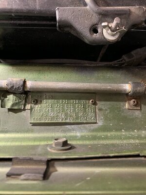

According to the Fender Tag (see first post) it looks like my car is paintend in F5 Medium Green Poly, right?

If it's a daily driver in Germany it will see a lot of weather, so I would leave the paint (it looks pretty good to me and adds to the coolness of the car), but give it a good wax job every 3 months. I'd be more concerned with the underside and inside the chassis rails and body panels. I would clean everything as best as possible and then spray everything liberally with Morris Ankor Wax to prevent rust (there's probably surface rust already but this stuff seals it - it's used by all the classic car guys in the UK). Your car looks awesome by the way.
The second row (down to up) of my fender tag.
F5 C6G F8 801 965050
http://www.mymopar.com/index.php?pid=87
Decodes to:
F5: Exterior Color
C6G: Trim - Charger, Vinyl Bucket Seats, Green
F8: Int. Door Frames
801: Build Date: August 01
965050: Order number
So i guess F5 is the exterior color?

The thing is my passenger door color is already a slightly different shade of green anyway.
So i could let them paint the door and see how it looks. If im happy with the result fix the rest, if not leave as is and just conservate the car so it wont rust.

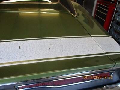

You need a bodyman with grey hair. :D ppg , dupont , both are just fine for what you wish to do. your bodyman should dumb down the color a touch with a drip or two of white to age it a bit. shoot the hood and see if you get lucky. If its off to far shoot the fender tops back masking off the top , sharp body line on the fender.
The rear stripe will pose more of a challenge. Outline that stripe with tape then start working on removal of the white decal,
eraser wheel will cook that old paint under the decal so leave it in the tool box. light heat from a heat gun { LIGHT HEAT } just enough the loosen the adhesive use a couple old credit cards to peel it No razor blades. If you do cook a patch just remember the new decal will sit right back on top.
Work like that just takes time, and it needs to look old once done.
Also , nice car man !

Yes a good paint supplier should have no trouble mixing your F5.
Body shop mix banks are set up for base clear mixing so your bodyman will end up going to a supplier and having them mix it.
I hope he will have a little white enamel on hand to dumb the green down a bit, New paint on hood will look darker than the rest of the top side surface.
Start off getting a 1/2 pint mixed then do a spray out and check the match, If you guys are happy get a pint mixed and get it shot.
you can play with that 1/2 pint , just keep track of , record, any tinting you do so once you hit it you can duplicate it.

BTW: there is no rust on the hood the primer just turned reddish.
