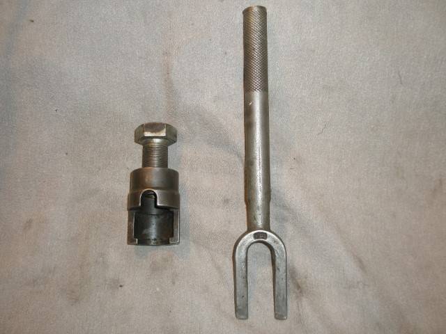

But there are tools to get the job done, too.
1. A pickle fork.
2. An Official "Miller Special Tools" separator from back in the dinosaur days.
I'm sure there has got to be a modern equivalent to this old tool.

I'v got that tool.
Picture in post #8.

And it doesn't damage the seal (just in case you're not replacing the bj)
Don't remember if I've ever used that tool other than busting ball joints loose on wrecking yard cars.
But ya, I'm pretty sure that you can position the tool under the bottom lip of the grease boot, and then wrench away, turning the big bolt.
