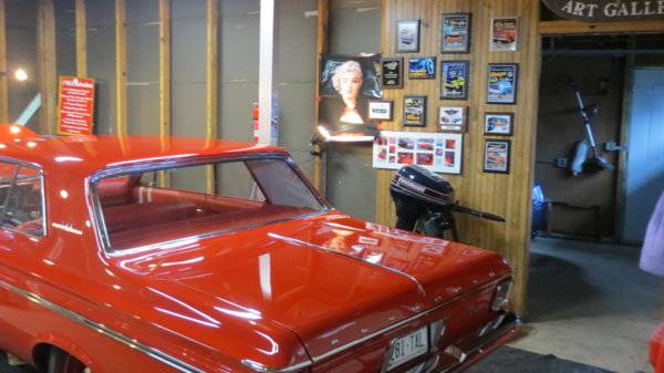

I cover the garage floor with tarps and cover that with a rubber membrane taped together .
I'll take a picture in the morning ..
yes I do to....must have moisture barrier to prevent it...also have Talc (baby power) on floor to prevent mice & moisture
