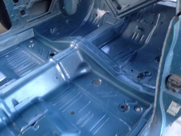

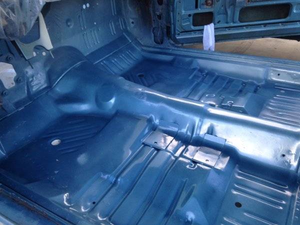

Have it totally stripped, do the back seat area first while youre in the car, back of the roof, then firewall. Get out of the car and do the rest of the roof and floor.
I've done 2 of them on a rotisserie now. Works great in the trunk area as well as the interior by turning the car on each side.
did you have to do metal work inside....floor pans or other repair?
Thanks for pointers, everyone. No, I haven't had to do any work on the floor pan or interior. I was very lucky, the guy I bought my RR from had that all done by a shop previously. @garrett1308 thanks for pics/instructions. Did you base/clear the inside just like exterior?
