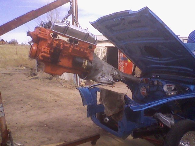

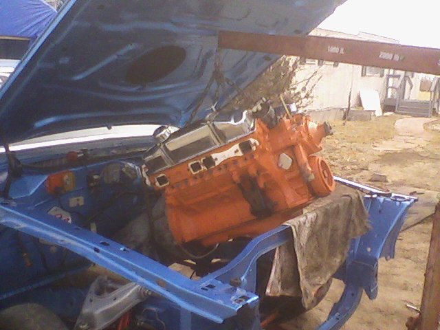

i leave my hood on . i leave the car on the ground so i can roll the car instead of the hoist, so im not jerking the engine around.

I had just pulled mine a few weeks ago ( a 400 out of a 73 Charger) and I got the back up high on jackstands and I also had a floorjack under the trans , I just pulled the engine only and used tie wire to tie up the trans to the fender support rods bolt. There are plenty of ways to get it done ( just don't pull it with the torque converter attatched for pete's sake !) , and learning how to do it takes patience and a plan , you have to put it back in remember !! take your time and take some photos of stuff you think you'll forget. DO IT !
