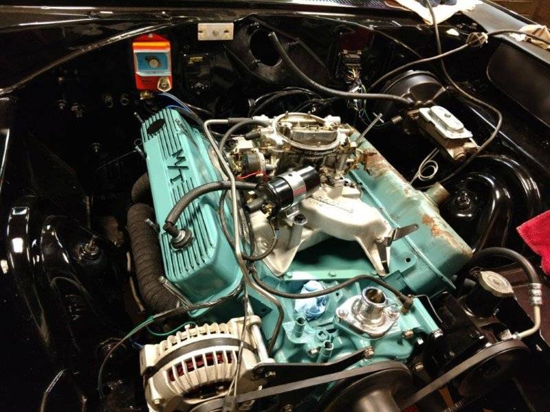

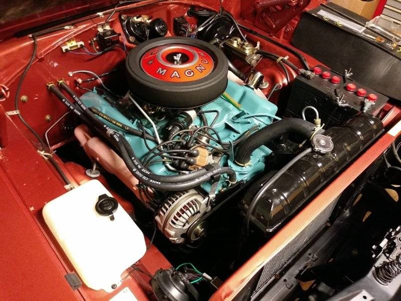

Guys, trying to determine how to bend my fuel line from pump up towards the carb on a 440. Coming up behind the Alt. is easy but the dizzy really hinders a straight shot....just wondering how the factory did it. Can t seem to fine a pix strumming thru my old magazines...
Like this:
Inline tube has oem sets very reasonably priced
You didn’t state what year, body, or carb configuration, but here is my 70 6bbl factory routing from the separator up to the carb.

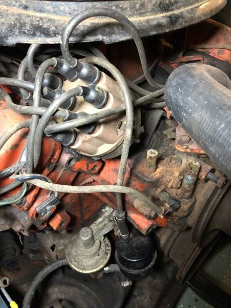

I'll take a picture of mine and post it soon.

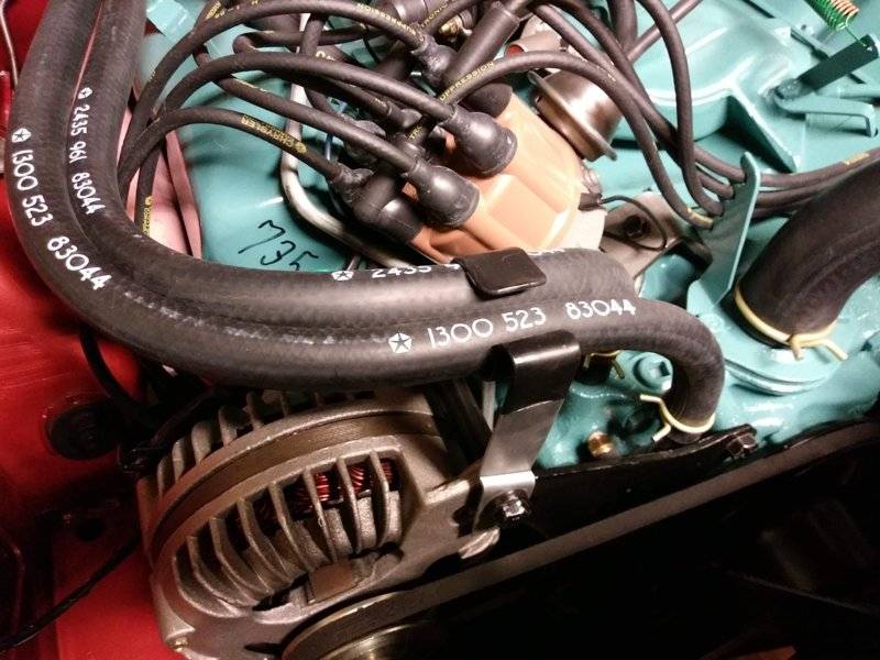

Good pix Don, so does the line go above the dizzy cap and wires...seems the line is gonna hinder removal of cap or valve cover somewhat...thanks...
