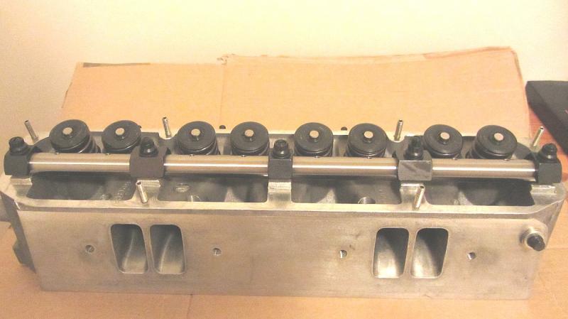

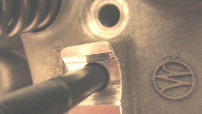

Checking everything before the heads go back on and I notice...
Difficult to tell in the pics but the stud is a lot thicker than the factory bolt, after the threads it tapers out wide, making the oil passage around it very tight. Seems oil could possibly be restricted to the shafts. Anyone running this Hughes kit? or should I use the factory bolts. There's always something to deal with :eek:
edit: toned it down as not trying to criticize anyones product. just looking for people running this stud kit, and results, im sure it will work fine!
I've got two engines currently running this rocker setup. No problems yet!
If I were you, I'd call Dave Hughes and talk to him about your concerns. See what he has to say about it.
Are the rocker lube holes supposed to be facing upwards? It's not that way on a stock setup.....
I've just sat the shaft any which way as somewhere to rest it. Holes will be the correct way when the rockers go on
Thanks, good to hear! I wasn't sure if it would be an issue, I just wanted to hear from people using them. It's a good kit, i don't like winding threads into aluminum too many times, so ive bought studs for everything
Im over paranoid but just like keeping things as Mopar ran it, i don't know what .040 or more restriction of oil flow will do through an orifice, that's what the engineers are paid to figure out, but i know the factory bolts with the aftermarket rocker shafts works properly
i just hate to get it all going and find rocker arms starving of oil at 7000+ because of something so simple. i much prefer using the studs over bolts into aluminum heads as one of them has already had a heli-coil repair done in the past by someone else. plus the HUGHES shaft hold downs are nice and solid
The clearance around the stud looks like it's good enough to me.....but one way to find out is to take a drill motor with a priming rod and see how much comes up. Don't forget to rotate the engine while doing this so the cam lube hole will align with the oil passage in the head.

Thanks yeah ive got the milodon prime tool, done all that before. There's no doubting oil will flow through, it's just difficult to know at high rpm's if it's enough volume getting through. Only solid dyno testing at those rpms or just running them in a car for long enough to know it's not an issue. guess i'll know soon enough. the Crane gold rockers im using are cheap to buy each if you wreck one, so im running them because i don't think any aluminum rocker lasts. the ductile iron do but are heavy. the Crane's are also better being honed a little for extra clearance on the shafts, and having all the factory 'as Mopar designed it' valvetrain oil. (honing depends how tight they come, every batch can be a little different) , i did it that way back in 1998 on a .590' solid 440 and never had an issue

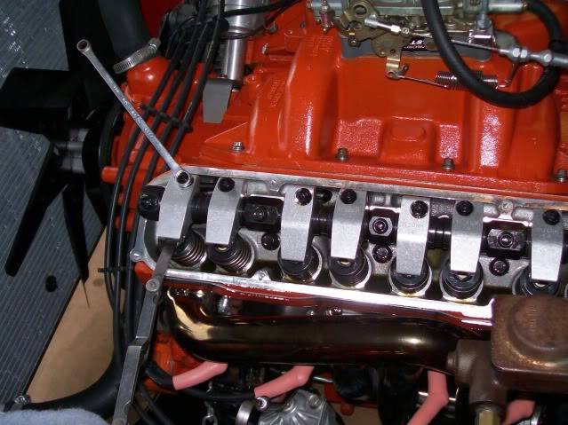

These are Hughes hold downs I use on my EZ heads. I took this pic when putting the inner spring back in after breaking in the cam. Its been in the car since 2011 with no problems. Not a great pic but its all I have. Ron
Here is an assembled pic. Ron
Thanks. Well looks like the Hughes studs certainly aren't going to be a problem, too much oil pressure up there.
I need one of those valve spring compressors, does someone sell that or did you fabricate it yourself?
I bought it from Mancini and it works great. Ron
