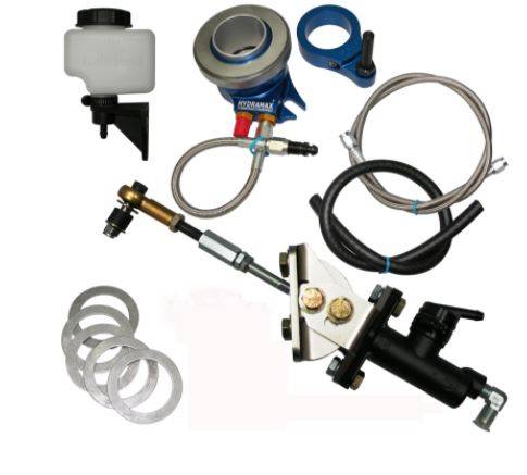

I purchashed the American Powertrain Hydramax Hydraulic Clutch Release Systems
Throwout Bearing Conversion for my A-833-18 spline, was wondering if anyone else has done this and what there experience is. Will be installing this weekend.

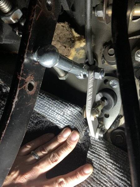

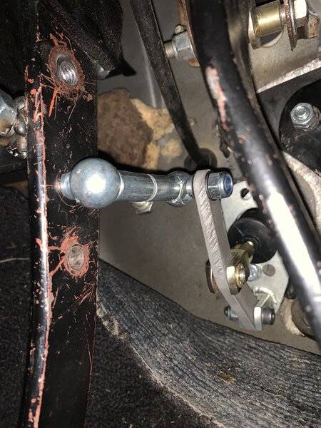

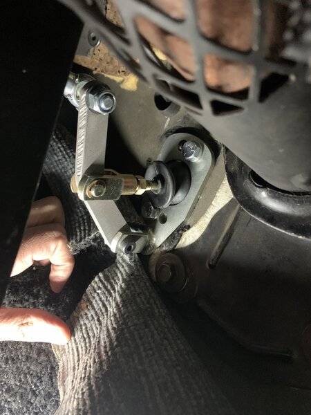

Have this but converted to another hydraulic cylinder and modified the linkage. Now it works much better.
Have McLeod RXT Twin Disc.
Very light and smooth pedal feeling.
Just like a new car.
