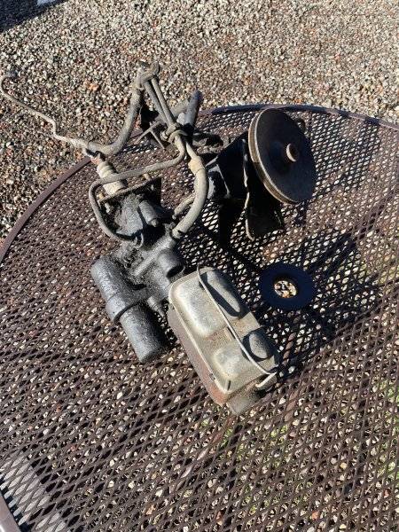

I will try and post information as I come onto it. I am pretty sure that I will be able to get the 85 D150 MC to fit onto the HB system. I spent some time researching all of the fittings and ended up ordering some so that I can make up some -6 AN lines. There seems to be some differing information about the hoses, however I think I will use braided PTFE lines.I will be carefully watching your progress. I have had HB in pickups and liked the system. Had a friend running it in a Chevelle with no issues. Doesn't seem like it should be tough to get it to work in a Mopar, but it doesn't seem to have much of a following among Mopar owners. In the meantime, I will be cleaning up this beast while I am cleaning other parts...View attachment 1418389
If nothing else, I know the pump was working with the HB, and that it was bolted to a 440. May not be much else that is relevant or useful since it was all on a Winnebago.
I am not sure why these are not attractive to Mopar guys, perhaps its the ascetics as they don't look all that great.
