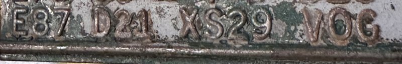

In other words....For example, a VIN XP29G0G indicates a 1970 Dodge Charger 500 with a 318 built in St Louis. Lets say the sequence number is 123456. Is it possible for that same sequence number to exist for a VIN that starts with XS29V0G ? The second car being a 70 Charger R/T with a 440/6 Pack. Could they both have the same sequence number or were those unique to each car regardless of trim level, engine, assembly plant?
XS29V0G? That sounds familiar…

The VINs I listed were just randomly picked, pertaining to nobody here in particular.
Any and all coincidences are purely accidental...
