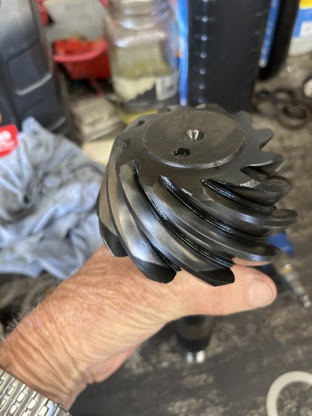

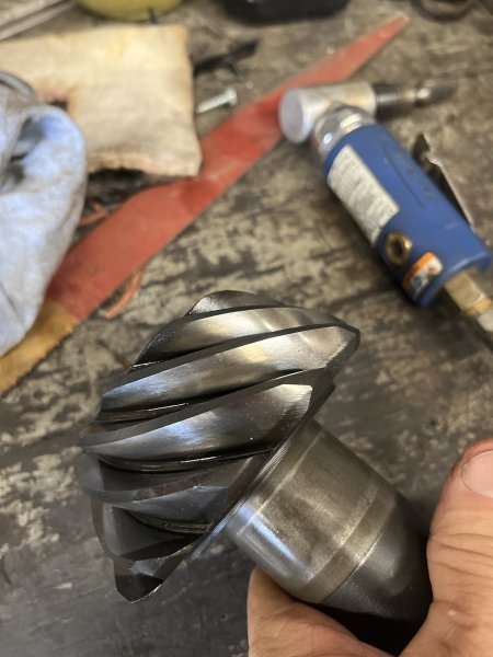

It was tried, thank you. There is a height difference between the pinion of the 3.73 and the 3:21. The 3:73 has a shorter head(teeth) than the elongated 3:21 pinion head.

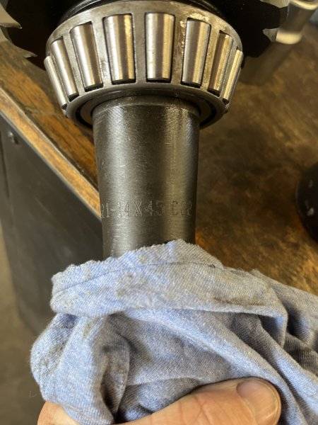

The shim for pinion depth is usually to shim for machining tolerances in the housing, not the ring and pinion. 99% of the time if the original shim was correct it will be correct for the new gears. If you don't have access to a pinion depth gauge a .020 shim is the starting point for a 8 3/4 with a 1 7/8 pinon diameter I seldom see a pinion depth shim that THICK that is correct. Look at the old pinon gear it the shiny wear pattern in the middle of the teeth?
Also helps to have a pinion 'dummy' bearing or one that's slip fit honed as a trial bearing. I'll even hone the new bearings if they are too tight. Never had a problem with a bearing spinning even at .0005" tight. Had one years ago that was .005" tight on a Dana 60 and thought the press was going to wreck itself and it was an industrial press. It actually pulled metal from the pinion fit. Anything over .001-.0015 is too tight in my book.
I have a fitting bearing that we did just that.
