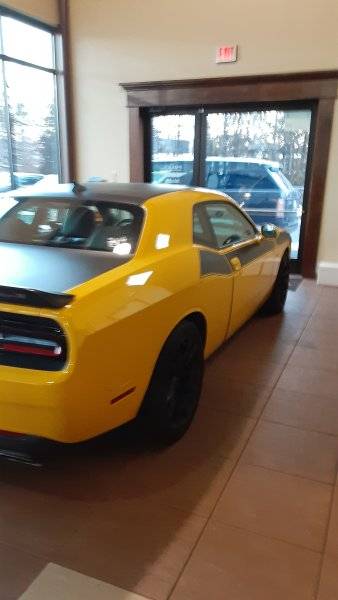

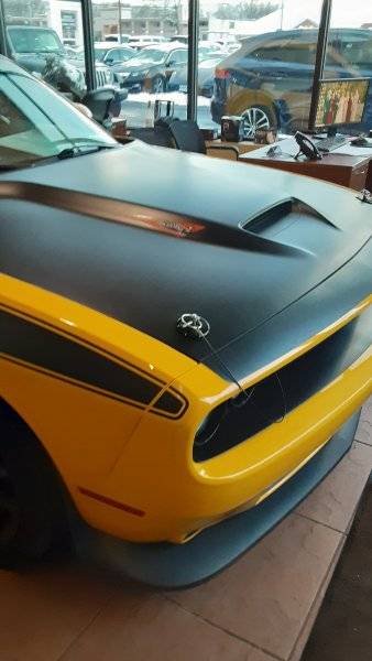

I have one of these. Same year, just a 5.7. Anyway I love it and have not had any trouble except the dreaded radio failure. The screen commonly de-laminates and causes the system to do all sorts of crazy functions. Of course my car was just out of warranty so for a cool $1300 my local dealer installed a new (refurbished) radio. The problem is they didn't know what they were doing, so back to the dealership countless times. That was last July and the remote start still doesn't work. Dodge don't give a crap and its like you can't get any help. I had to give up as I work overseas. I will be kicking some *** when I get back. But seriously, apart from that I love my car.I was trying to buy this 2017 392 six speed Challenger T/A with 28k miles on it, but the dealer refused to negotiate with me on it. It was twice the cost of the 2010,and I would have had to take out a loan to buy it. Then I saw the red one that I could buy without taking out a loan.

I’ve no experience with the Hurst in these cars, but check out the Barton shifter. I put one in my 2021 Challenger and love it! It comes with a pistol grip as well. Another huge difference was removing the Clutch delay valve…..improves the feel of the clutch dramatically. Awesome cars!Thanks! Because the car has the T/A style hood,my plan is to black out the hood,add hoodpins,a set of Year one rallye wheels,a Hurst pistol grip shifter,and a T/A stripe kit. I might even do electric exhaust cutouts,with chrome megaphone exhaust tips coming out infront of the wheels.

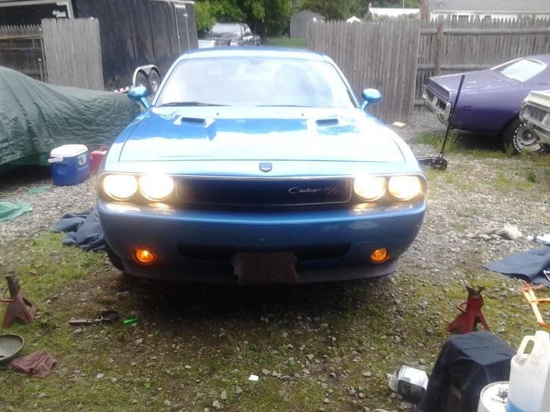

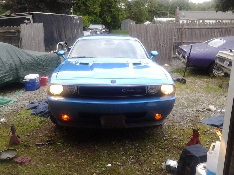

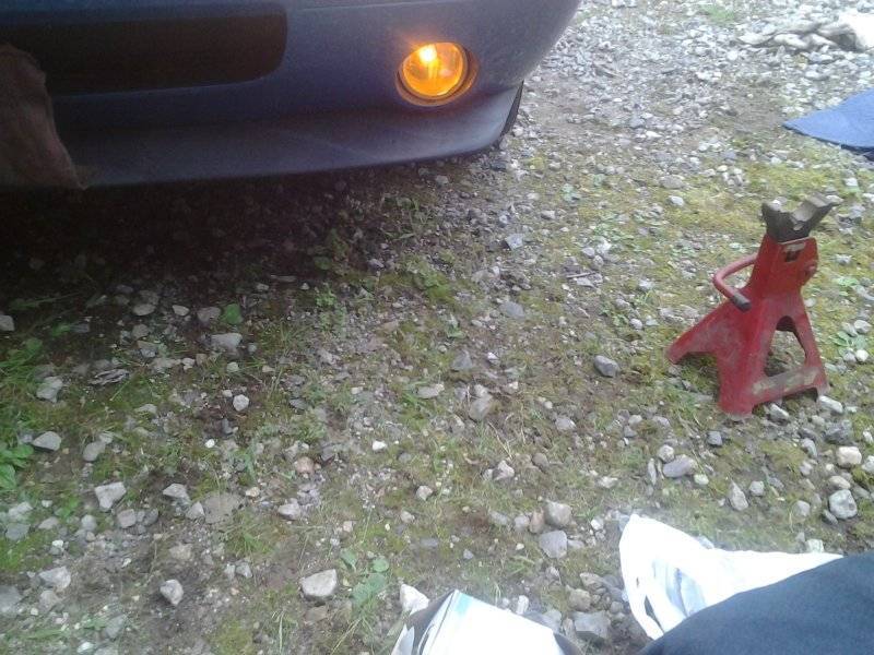

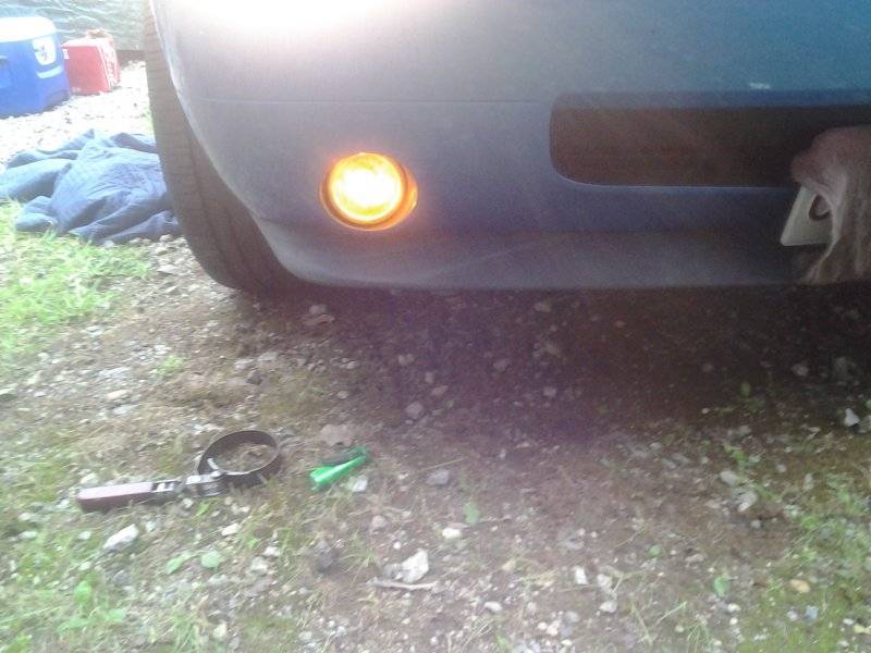

I agree with you on this mod. What was all involved to do what you did here? Looks great.One of the first modifications I will be doing is reconfiguring the lights to 1970 Challenger configuration like I did on my wife's car. I cannot stand the amber directional lights in the inner headlight pods!
I had to modify the fog light housings to receive the larger directional light sockets and extend the wires so they could reach the housings in the bottom of the bumper. I then glued the socket pieces I cut off the back of the fog light housings into the back of the inner light pods and extended the wires so they would reach as well.I agree with you on this mod. What was all involved to do what you did here? Looks great.

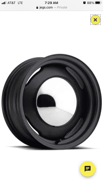

Too funny, don't give the dorks any ideas or they will make dork dish wheels and stupid dog bowl caps for modern Challengers and Chargers too!Too bad your favorite dork dishes only come in a 17”, I guess rally’s will have to do![]()
