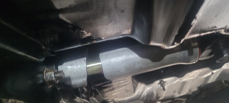

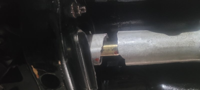

So since I got my car last fall it's had a small driveline vibration that increased with speed...I know, I should have sorted it out then. The other day I increased my speed considerably, lol, and heard/felt a thump and a giant trail of smoke immediately followed. But then right away the vibration was gone and everything was smooth. I was nearly home and it shifted fine to get home etc. When I got under it and took a look the tail housing was in two pieces.

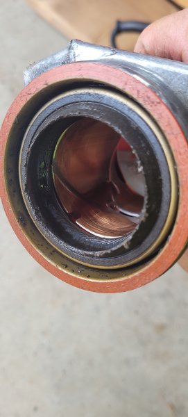

I think I have found the culprit. Bushing is wore down to copper and lots of play when slip yolk is in.
