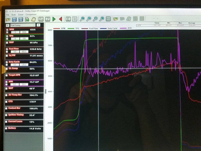

Here is a pull today. WOT, RPMs climbing slowly and you can see the afr start to break up with the spikes. Fuel flow and duty cycle continue to climb out of sight.
Change your CL comp limit to 100 from 50 and see if the fuel flow can keep up. Right now you are running the engine lean because you have a limit set. The Sniper can't add fuel due to the limit you have set. You've hand cuffed your Sniper and if you keep going WOT like that you'll damage the engine.
Huh, somebody said misfires will show lean...
Those spikes are lean... so misfires?
Or no?
I am just getting into this EFI stuff and are reading up as i can, but from what i understand the CL (Closed Loop) mode will not be active during WOT right?
The extreme AFR spikes at the moment the throttle is opened and closed are understandable as there is an extreme change in conditions.
The AFR readings during the period of WOT also show spikes, think that is something that needs to be sorted out?
I guess you are correct that those spikes during WOT might be misfires.
If you would pull an average line of the AFR during the WOT period it just gets a little leaner as rpm increases.
Too bad there is no AFR scale on the chart to see where it is at, although it says an average of 13.6 in the right top makes me think it runs on the lean side, but that will be included to 2 big spikes which are not really applicable when looking at just WOT.
I changed the parameters prior but maybe it didn't save. Educate me a bit on this. I thought the CL Comp % was the amount of fuel being added to the base or subtracted (shown with a minus) from it. So I thought the 50% number was showing that 50% more fuel was being added to keep near the target afr?

If you look at the chart, the intersection of the white horizontal and vertical lines shows exactly what the sensors are seeing at that moment. 13.7afr is what is shown for THAT point. But you can see that the longer at wot (as shown by the tps plateau at 93% open) the more afr fails to maintain. And duty cycle goes way up along with fuel flow. I'm not sure the fuel flow shown is correct.
The fact that the duty cycle goes way above 100% makes me think it is trying to deliver fuel it needs to keep up.

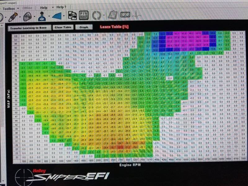

Verified all 4 injectors are firing. Looked at the learn table and you can see how much fuel the Sniper was trying to add at wot. My new pump should be here Tuesday so I will clear the learn table and start over with the new Walbro 450 installed.

If the engine is misfiring it will show a false lean read in the 02 sensor right, and the sniper will try to try to go rich in response right?
That’s what’s the learn table is showing here correct?
That the O2 is showing leaner (cause not determined) at high rpm than the baseline and the efi is trying to compensate

A misfire will show as lean because of the extra unburnt O2. The spikes could be misfires, yes. Until I get a pressure gauge on it, I won't know for sure. Because the spikes start after wot and not immediately I still believe it is fuel availability dropping. I dealt with pressure loss with a mechanical pump before and the car acts the same... strong on the throttle and then leaning out after a few seconds wot. I had pulled the plugs a week prior to the Sniper install and the plugs were a bit on the lean side. Gray/tan, no soot.
And I would think with a misfire the rpms would break up as well.
