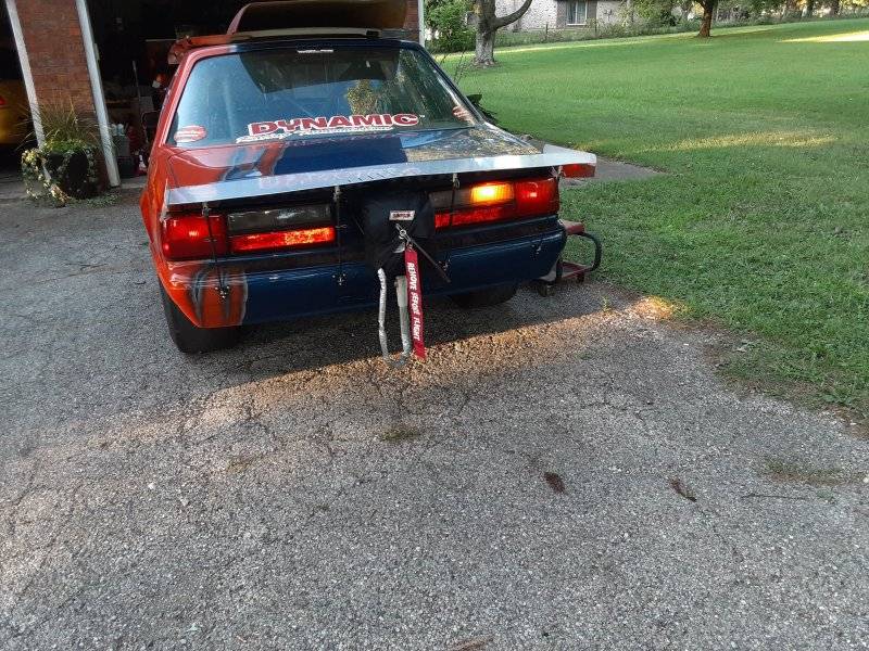

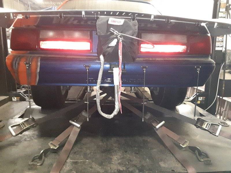

I have to install a horn and button, fab a license plate bracket off the chute mount w light, remove passenger turbo header and have leak fixed, replace leaking wastegate. Get DOT front wheels and tires, take off the bogarts. It'll have weld racing wheels all around. This is my street/race car and is not a mopar unfortunately.
Hate to do this on a mopar site, but here goes.

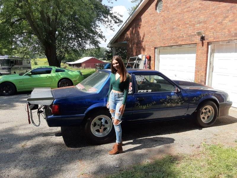

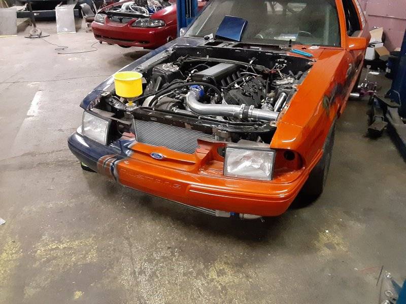

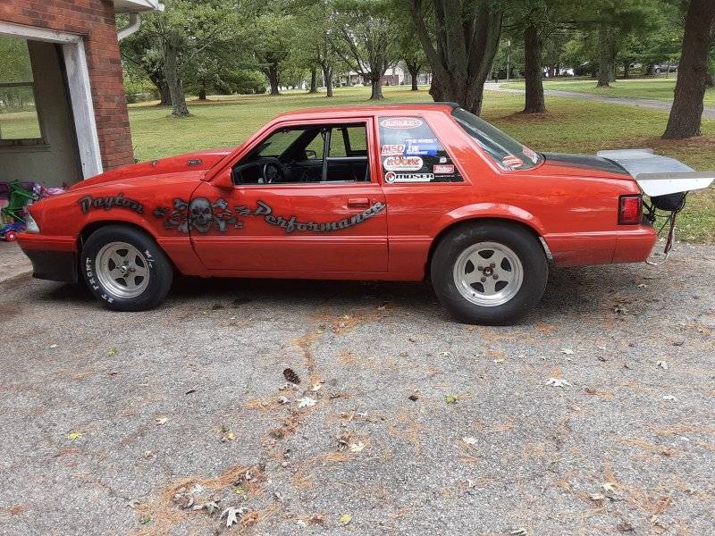

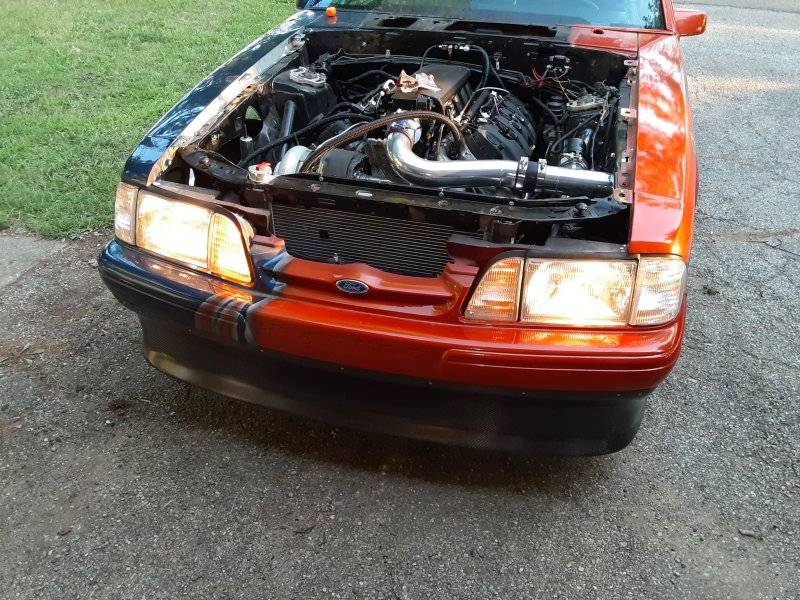

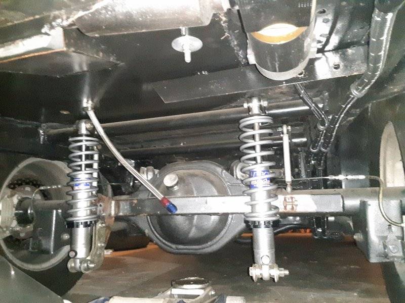

Flame away! But seriously, thanks for the interest! I built this car from a 300 buck shell into what you see here with only subletting paint(trade) and chrome moly 25.5 cage. Turbo piping done by my friend Jason Z.
Coyote engine?
Yessir. I am about as broked*** of a racer as they come. I built the engine, has ebay 03 Cobra manley rods and a set of shelf Probe pistons, stock truck intake cams, boss exhaust cams, and a 350 buck 6R80 F150 auto and converter. That was 350 to my door. Lol. It's been a best of 9.30 with a 1.7 60ft, and 155 mph. Turbo I bought for 150 bucks offline, and seent it out to a turbo place in cali, he rebuilt it and promptly knocked it off the bench and onto the floor breaking the compressor housing and crushed the wheel, so he fixed that and put a dual bb center with a billet compressor wheel in it and still only charged me 1200 shipped. Currently down to 16 psi of boost working my way back to 19. Stock crank and block btw.

Need a sticker on it saying 'My First Love Is Mopar' :D
Yep, got one just like her! And those stinkn jeans are about 120 bucks new and already ripped! LOL
Just having fun buddy, congrats and go show them how its done! Best of luck
Thank you. Nice to know I'm not alone. She's almost 18 and she's a senior this year.
