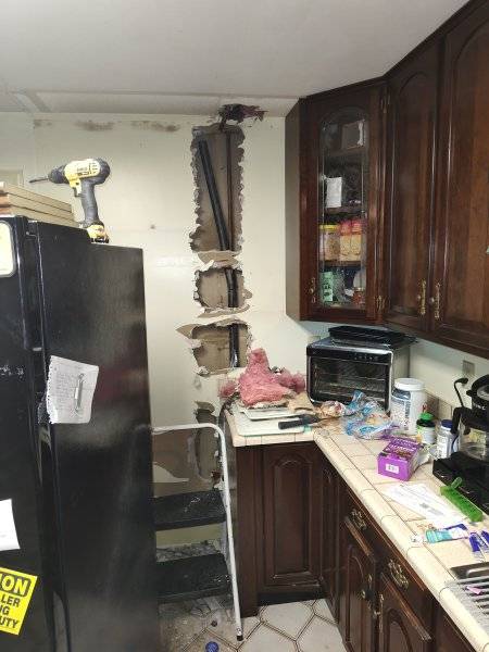

Woke up this morning
Smiled with the rising sun
Went to put clothes in the wash
And there's a leak coming from the main feed line where it tees
I will repair it
But it's a PITA and I am not a fan of plumbing
Ok, that's my rant for the day

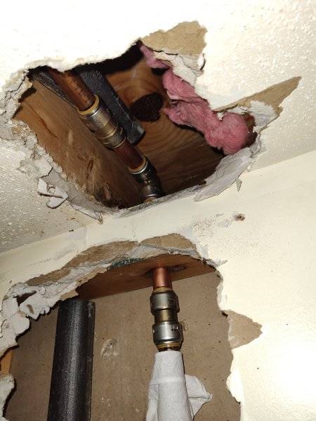

I've had excellent luck with the SharkBite connectors. All you need is clean cuts, and they will connect copper to copper, (C)PVC to (C)PVC, copper to CPVC, they even have PEX versions with the proper insert. MUCH easier than soldering with a torch , especially in tight spaces.
Look at the package, 1/2" pipe connectors will slip on 3/4"; 3/4" pipe connectors slip on 1". Pre mark your pipes to make sure you have full coupling, and they're a snap (literally) to work with. Hint: spend the 2.89 and buy the orange horseshoe release tool for the size pipe you're using. Trust me. You'll probably have to un-couple at least one connection before you fijish
On the apartment I'm redoing, I solder copper for anything "structural" - i.e. valves people could be turning, and the main feed into the unit (water main to shutoff valve; shutoff valve to hot/cold split; split to cold feed; split to water heater).
From there I just SharkBite convert to CPVC, and glue my way through the apartment.
Stub-ups through the floor to valves (sink, toilet) I go back to copper and clamp securely to a stud or joist for strength for when people have to mess with them and I always use metal valves, not plastic; the tub/shower manifold and piping is also copper for strength. I don't want plastic anywhere people are going to mess with it; it gets brittle over time and I'd rather have any torque loads go to copper that's securely mounted.
I like working on incoming plumbing a lot better than working on outgoing plumbing!

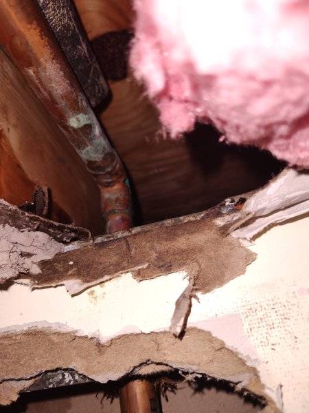

Had a leak in my kitchen wall last fall. Pinhole in a copper elbow (had to start low and work up till I found the leak)
I cut it out, got a SharkBite 90, cut the legs to fit, and used SharkBite connectors to put it all in so I didn't have to solder inside the wall

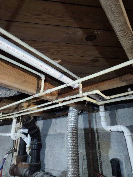

But I am proud of my feed manifold (post 3 pic 1). Zero leaks, perfect fit, first time.
