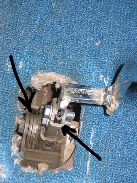

mine has this
AWFnuI1WkcmA5CFlA80TKNHMnvf5akPRFars4ONBQ_TAQL_7zOQRNSB-idEsozQ5dw8sj7FMMtJytX27AZ31pxdYsZAJk_rA.jpg
4 speed transmissions have 3 levers.
* 1st gear/2nd gear
* 3rd gear/4th gear
* Reverse.
There are some 1970 and later models that may have additional linkage for the ignition lockout.

The pix in the #7 post looks have been cut and welded back together by a blind shoe maker. But I guess functionality is more important than appearance...and everything will be hidden by the noot....
Yes, the linkage to lock the ignition is attached to the reverse shift rod, that the trans must be in reverse b4 the ignition switch will lock. Most of the time all stuff removed when installing headers. A one year feature...1970 only. 1971 used a thumb latch on the column to lock the ignition. Just my opinion of course.
The picture was to illustrate the shifter mechanism is not the same as the shift lever.
The welding appearance is ugly but it held together. My "flux core" welder and my limited skills at that time deserve all the credit.
The shift "BOOT", did cover it.
Yeah...and a car that is probably worth $40,000 or more.
Yes....flux core welding takes a little practice....were you using a shield gas also ? Sometimes the chrome plating would contaminate the weld, resulting in porosity or embrittlement of the weld. 75%/25% argon-CO2 is a nice mix for flux core. Some people like it as you can run a little hotter for better penetration plus flux core is good for windy conditions. Just thinking out loud...
