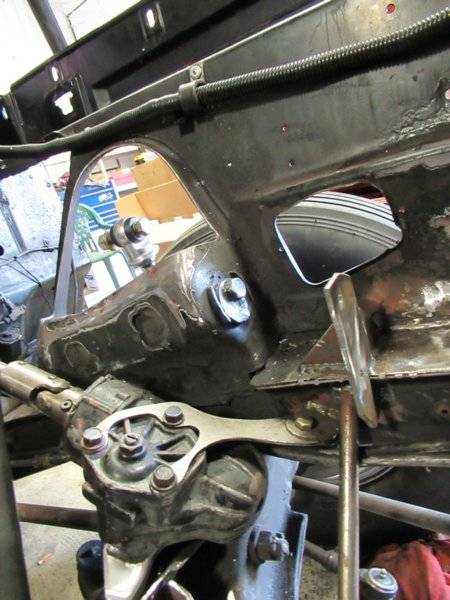

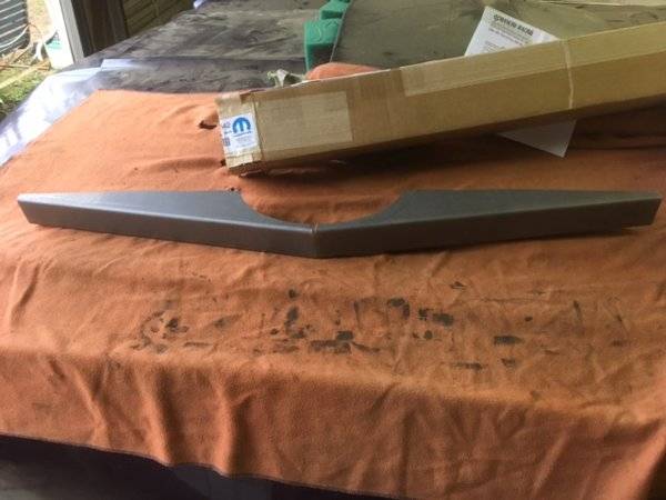

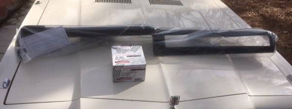

What year & model make did the 8-3/4 come from? Any mods to the perches?Some parts came in. A Dash cap, polyurethane K frame bushings View attachment 572892 View attachment 572893 & a back brace for the 8 3/4 rear I’m putting in it.

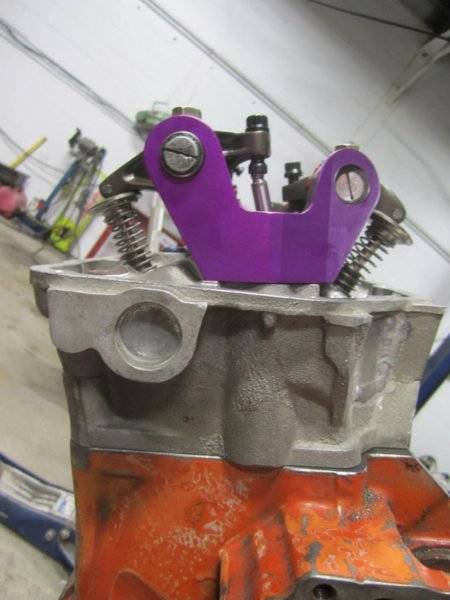

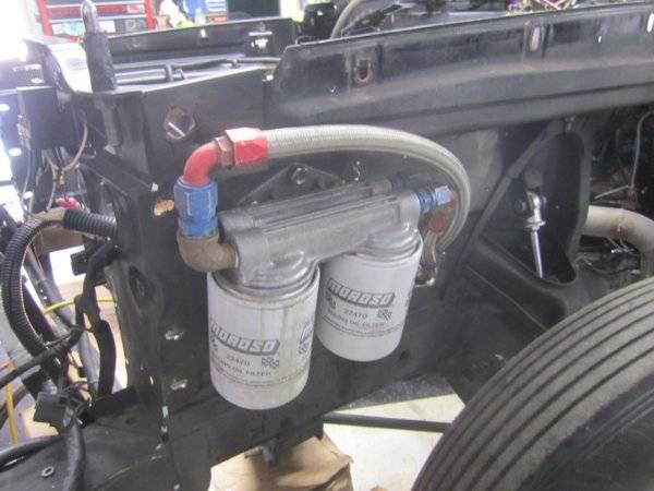

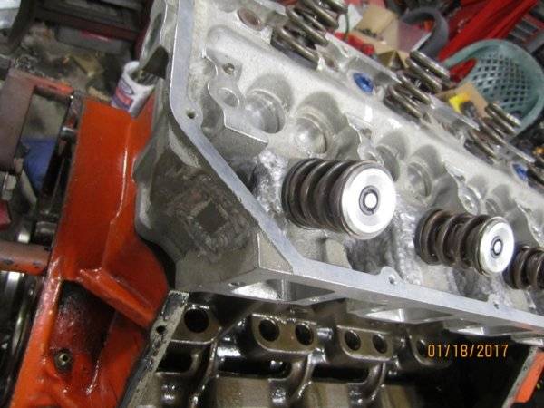

Aluminum heads & rocker stands,aluminum driveshaft,aluminum oil pan,eliminated the dual oil filter set up,trimmed some un needed metal to make some space. Yet I added a "J" bar and a few braces.Still looking for another 50!Where did the weight loss come from? You or the car??I lost 40+ lbs but found 5 of em and seem to be hanging onto them for now.

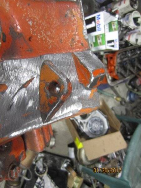

1968 C body car. Perfect fit for a mini tub. Yes I will have to move the perches. Already found some 12 in wide drag lites with the correct offset. I’ve measured 18 times haha. Should fit nice.What year & model make did the 8-3/4 come from? Any mods to the perches?
But you don't have to do big welds to make the reinforcements do the job. Keep in mind that big welds does more pulling than light welds....IE, the metal moves taking it out of alignment.I like the Calvert perch and their sliders.If you go with a stock perch,reinforce it!
