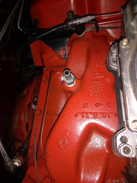

UPDATE 4-30-18:
I get done with work stuff and it's time to face the music awaiting me in the garage...
Plugs all gapped (all the store had were NGK V-Power. Yeesh.)
I get to where I'm feverishly working away at replacing the plugs on the worst side (passenger).
First two from back to front sure enough are gas-soaked.
Then I pull #4 and hmmm, not so bad.
I'm holding that plug up to have a closer look and then I spot it:
My immediate reaction:
Mopar 3b called it....and I'm an idiot.
Went ahead and replaced the rest of the plugs, capped off that damn port (I need to find a 3/8" plug to do the job right!) and hit the key.
Yep, she sings like she always did.
