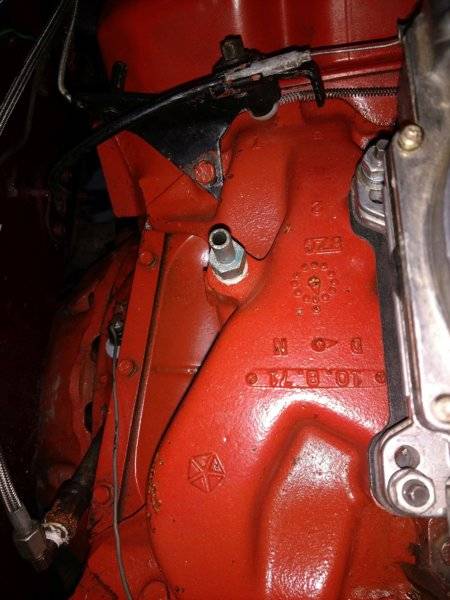

UPDATE 4-20-18:
I get done with work stuff and it's time to face the music awaiting me in the garage...
Plugs all gapped (all the store had were NGK V-Power. Yeesh.)
I get to where I'm feverishly working away at replacing the plugs on the worst side (passenger).
First two from back to front sure enough are gas-soaked.
Then I pull #4 and hmmm, not so bad.
I'm holding that plug up to have a closer look and then I spot it:
My immediate reaction:
Mopar 3b called it....and I'm an idiot.
Went ahead and replaced the rest of the plugs, capped off that damn port (I need to find a 3/8" plug to do the job right!) and hit the key.
Yep, she sings like she always did.
Did I mention I'm an idiot?
I saw that in your picture of the carb linkage but you were talking about plugging up the pcv hose. That's a big vacuum leak!
Get err done! :thumbsup:

Ed, you could’ve thought up another reason- broken ceramic insulator slid down to block the spark plug electrode(saw it once). Glad it was easy. Jeff
LOL When I looked up and saw that port, there might as well have been that DA DAAAAH music of discovery in the background. :)
Thanks as always, my friend.
(Goes back to look at pic)
Damn, you're right! Man, why didn't anyone say anything? Why didn't I see it? Sheesh...
Lol, I figured you had your pcv hose there and knew it was off. It's all good!
Naw, it's hooked up to the front base of carb like normal. I reckon that port is supposed to be for power brakes.
Screw it out and screw a pipe plug in it if you're not useing it. A rubber cap could blow off if she encounters another backfire.
Yeah like I said earlier, I need to fetch a 3/8" plug - at least, I think it's 3/8".
Can't believe it wasn't whistling Dixie. Put on a hemi intake on and started car heard it whistle. Somebody drilled through heat tube mounting holes, $50 manifold. Put a bolt in hole good to go.
Maybe a blessing in disguise. If you plug it, the pressure in a backfire has to go somewhere and could cause more damage. Now that you know what it was, maybe leave it the way you had it capped. Keep a spare in the car if it blows off again and disappears.
UPDATE 4-20-18:
