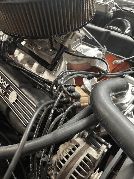

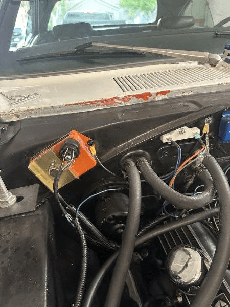

What does the fuel line metal and rubber look like from the fuel pump to the carb?
Where were you measuring fuel pump pressure between the pump and the carb?
Pictures of the fuel lines from pump to carb to get a second set of eyes on it?
Everything from tank to carb is brand new and has been double checked for any plugs/debris. Fuel pick up and steel line has been upgraded to 3/8 stainless. Brand new Edelbrock fuel pump and I have brand new 3/8 rubber fuel line from pump to filter to Edelbrock fuel feed fuel rail for VRS carb. All vents on tank are new and I have tried removing fuel cap. Cam lobe appears to be ok visually as it’s moving rod in and out about .4-.5” near as I can tell. I don’t know what the spec should be.
