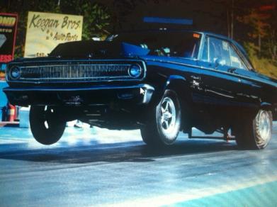

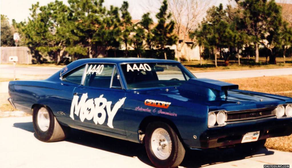

How bout one of these? The car was still pulling pretty good at the stripe with this scoop....
