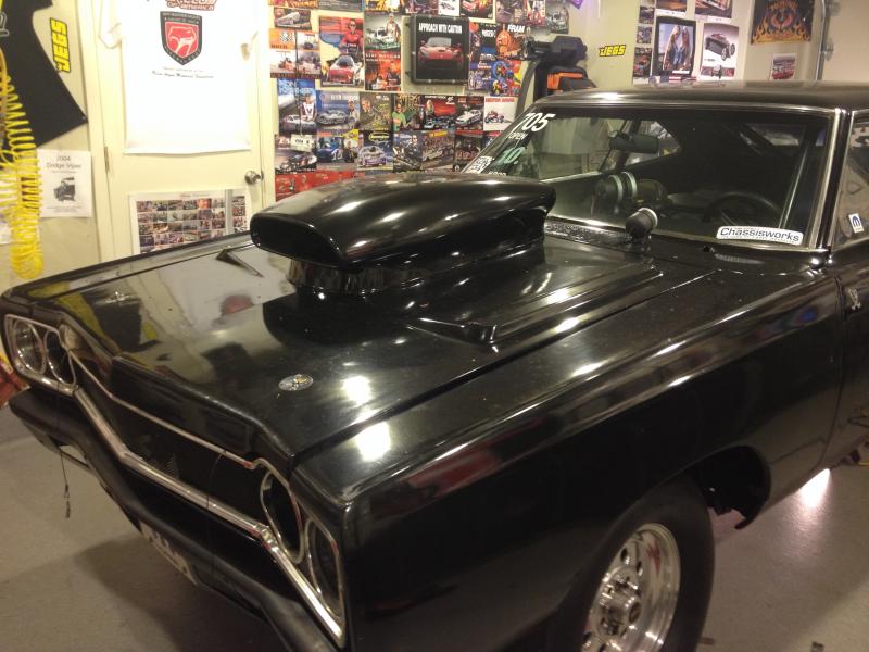

I looked already. I cant use a steel scoop on a fiberglass hood.
I thought it was a steel hood, with a glass scoop...lol...oh well...
good luck
I turn my head away when I see a Mopar with a cowl hood, I guess it's a Chevy thing.
Your at the point where function has to rule over form.
The aero scoop you chose suits the car a little better because it has a flat oval opening that is more similar to the grille than others.

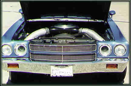

View attachment 217754here is mine. Actually had some other ideas about making two ducts from the headlights to the 1050 and losing this scoop all together.

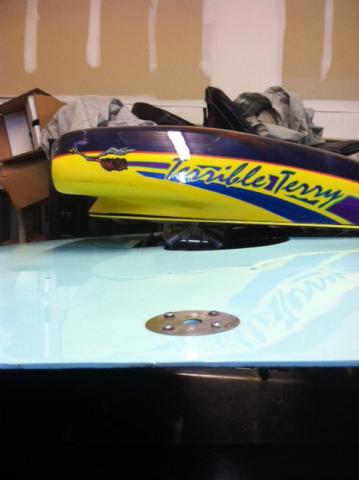

I think I am going to sell the hood and the scoop as one. Maybe trade for new glass hood and some cash.
Maybe lower that motor an inch or two and take out a few of the one inch carb spacers and you could run a lower Mopar Hemi scoop. I make scoops for a portion of my living and that has to be the most that I have seen a set of carbs sticking through a hood. It may be a tunnel ram that is used and if that is the case, go with a nostalgia pro stock style scoop.

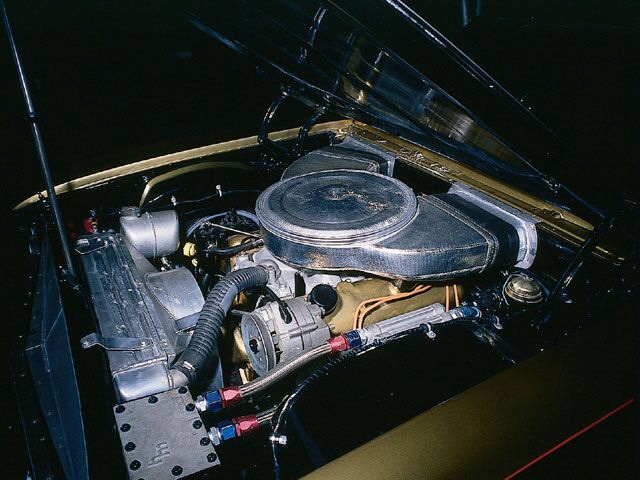

I like both of those ideas I had never seen the air intake facing the firewall. Short runs are best thats for sure. Cooler is better. I am trying to find a good duct material that wont absorb to much heat. I would also like to find the interior to be smooth. Not sure if that matters but any thoughts on this appreicated...

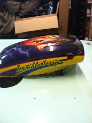

That is not very nostalgic?Going to try this one. Got to get the car to the body shop to get it all glassed up. This should work.

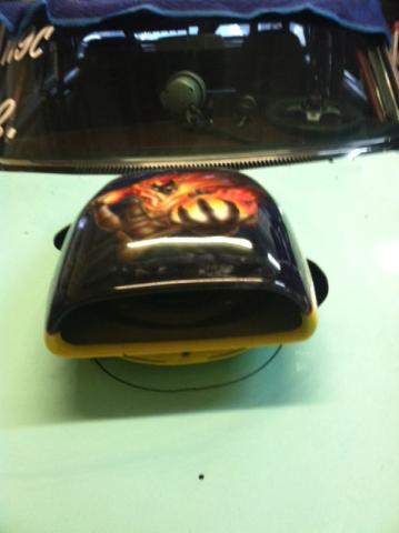

What about your scoop you have now with a series of 2" holes drilled across the rear with a black mesh inside across them so the scoop flows and doesn't "hold" the air. With the mesh it would hardly be noticeable and would allow the air to pass thru.
