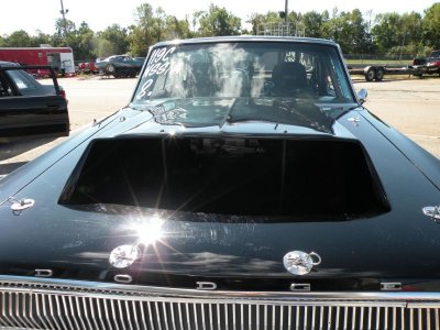

I want to try a different hood scoop......
From the research I've done, I think a RA system is better however, you would need to use a cowl style hood to slick up the front of your car and cover the carbs so you may as well use it. How deep into the 8's are you running and how much of a bulge would you have to have in your hood to cover the carbs?

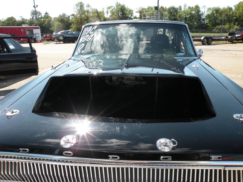

Mid 8's and I'll need 3"+ from the opening of the hood
Mid 6s with a hole in the front of the car...

Have you actually ever run a cowl yourself? The gap at the windshield is critical. Testing has shown us that there can actually be lower pressure inside the under hood area, sealed area (measured with a racepak).

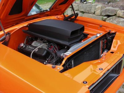

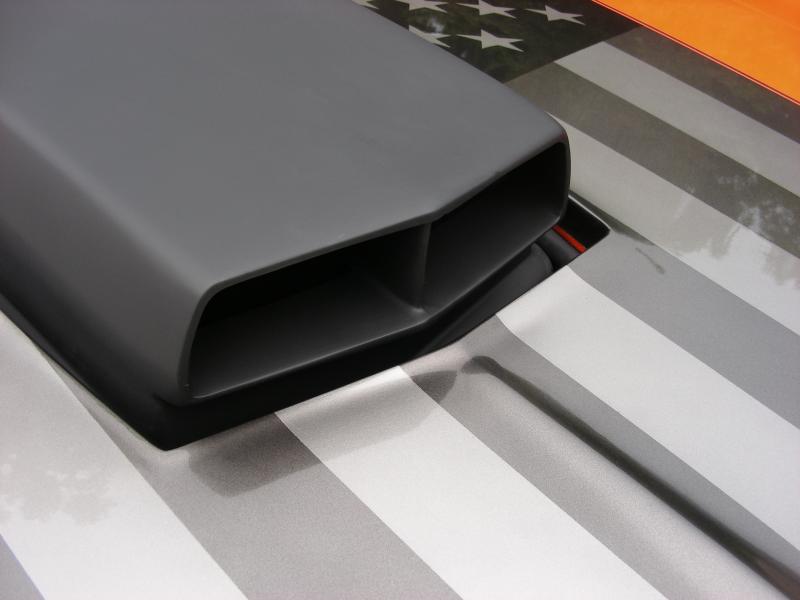

Ever thought about making your own? This is the shaker scoop I made for my Charger, just cut a mold out of wood and glass away.

At speed, there is a boundary layer of air that sits right on top of the hood. This air doesn't move much and is not a good source for the ram effect most people are trying to get when they use a scoop. The opening in the scoop must be above the boundary layer of air for any ram effect to take place. The old Direct Connection Bible had a good section in it regarding hood scoops... I may dig it out and post some pics out of it.
I think your 100% correct, that the current hood scoop is hurting your ET & MPH, it's a little overwhelming aero hindrances/disadvantage already, but cool as hell none the less...
But the one Harwood scoop you had showed in the link,
isn't to bad for a dedicated a Race car...
But can you get one already molded to the hood from someone ??
Paint it, then just swap hoods when & if you need to be more Mopar correct looking,
seems there's always a tradeoff when it comes to style & speed, especially nostalgic appearing, but that's really your choice, on how to apply it...
IMHFO the easiest, most aerodynamic & probably quickest too,
would be the Cowl Induction Hood
{even if it's originally a GM style hood, even they never had a 6"-8" tall version either}

I do have a spare hood to put a different scoop on, and swap out if needed. I do need the original hemi scoop for another project so this might be the way to go.
I'm leaning towards the aero scoop right now, but just not sure.
My bodyman will hve no problem glassing in my scoop to the hood. He's going to have to fill in the holes anyway.
