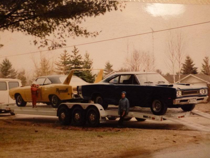

LOL.. here's one of my deck trailers. Picture is from Spring 1990.

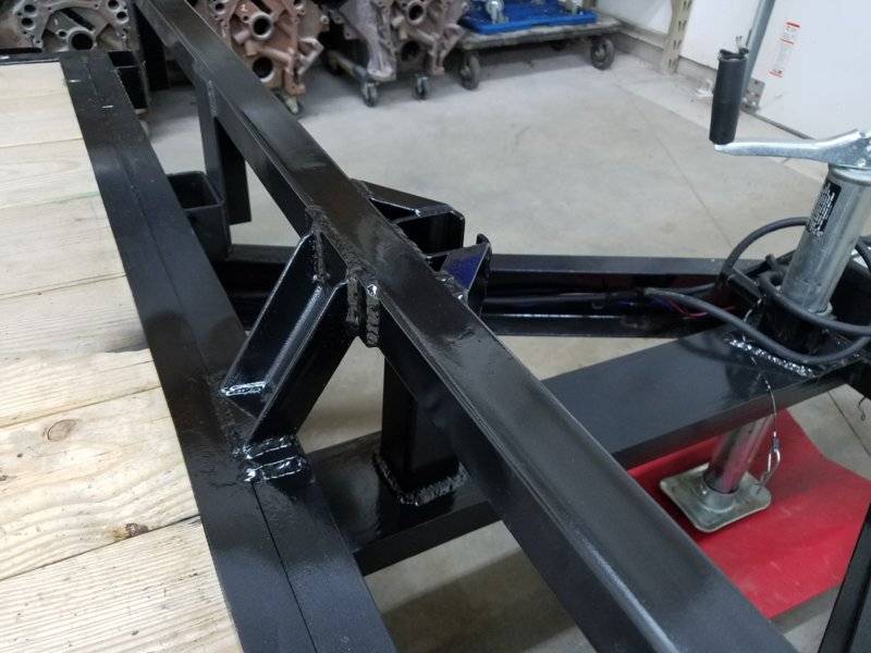

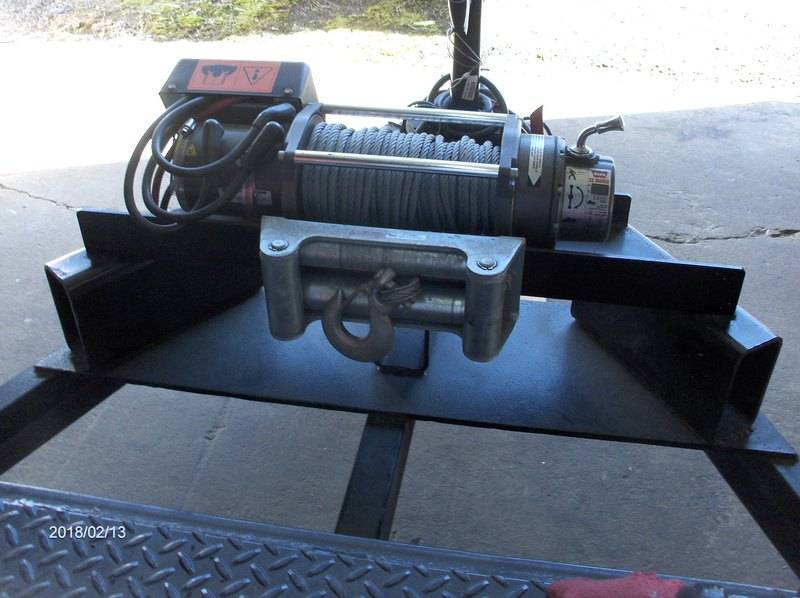

Made this from scraps of new metal laying around my friends shop.
Piece of flat steel and three pieces of 3X6 welded together and to the trailer frame arms.
We used the winch mounting plate and welded it to the 3X6 pieces.
Using the winch mounting plate enables me to remove the winch if I choose by unbolting it from the mount plate.

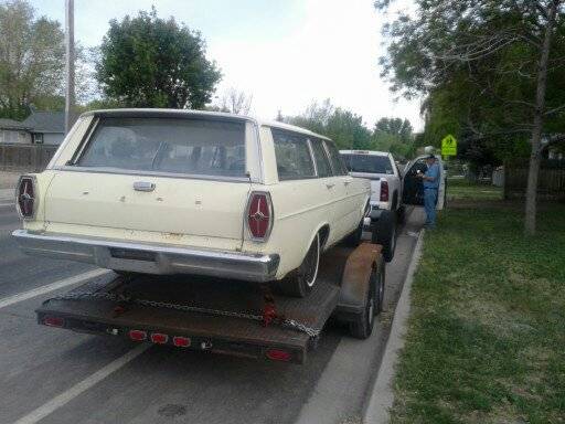

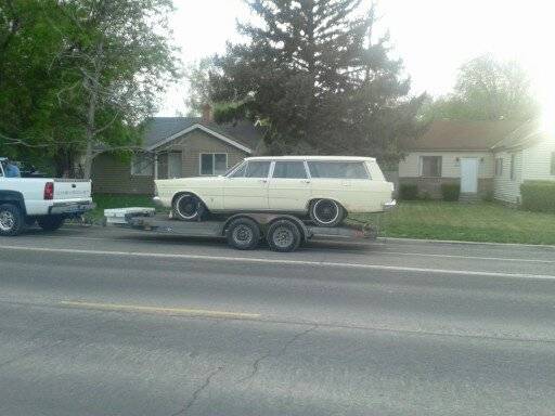

Here's a couple shots of my Parker 18', steel deck, dove tail trailer, with a '65 Galaxie wagon on it. I bought the trailer in 1999 and went with the 18' because I wanted to put any 50-60-70s vintage car on it. I went with steel deck because it was cleaner and I could mount hold-downs anywhere I liked. It has 2x 3500# axles and with a small block E-body on it, weighs in at 5600#s total, so the trailer is over 2000#s Biggest limfac (IMO) is keeping tires on it. They rot off long before the tread is worn. I have 15" wheels so the trailer sits lower, but that will lower your total available weight rating.
If you are ever going to tow something really nice, I highly recommend a deflector for the front to protect from road debris...

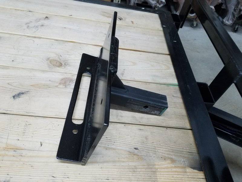

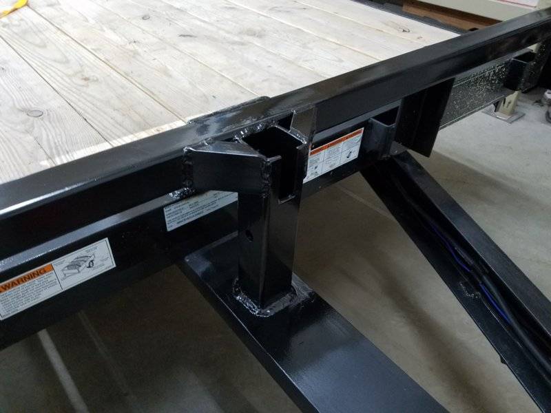

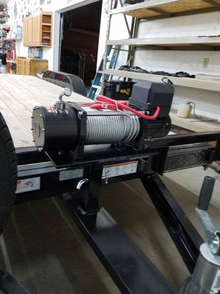

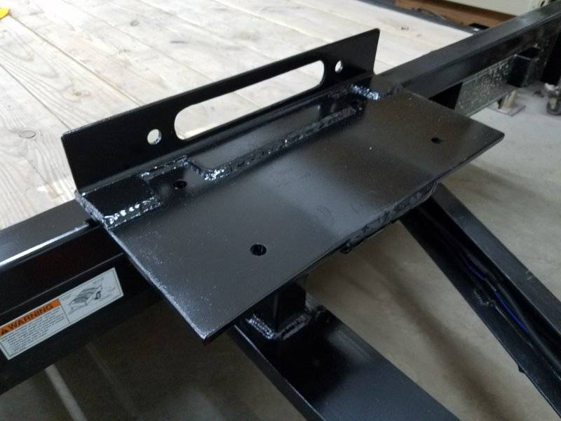

Thanks for all the ideas guys. Went with a 18' Road Warrior dovetail because it had all the features I wanted and it was in stock. I realize that if a guy was making a living hauling cars, you would want a bigger, heavier duty trailer. But for the limited time this will get used, it should work just fine. I took a different approach on the winch setup, basically because I wanted it to be easily removable. Made my own baseplate and welded a receiver tube with pin and bracing vertical on the tongue. The 2"x2" square tube going into the receiver is solid stock. Just have to get a battery mounted by it and it will be ready to roll. If it doesn't work, I will come up with plan "B".
