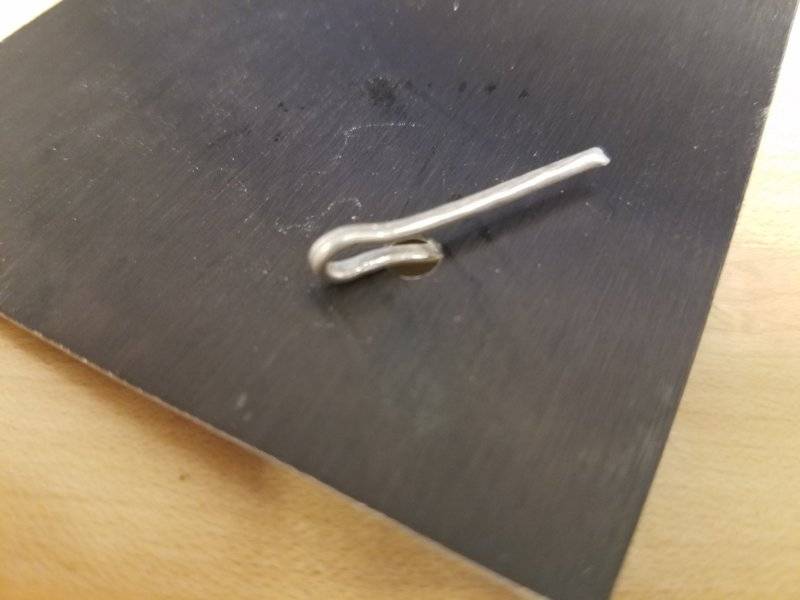

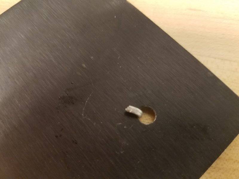

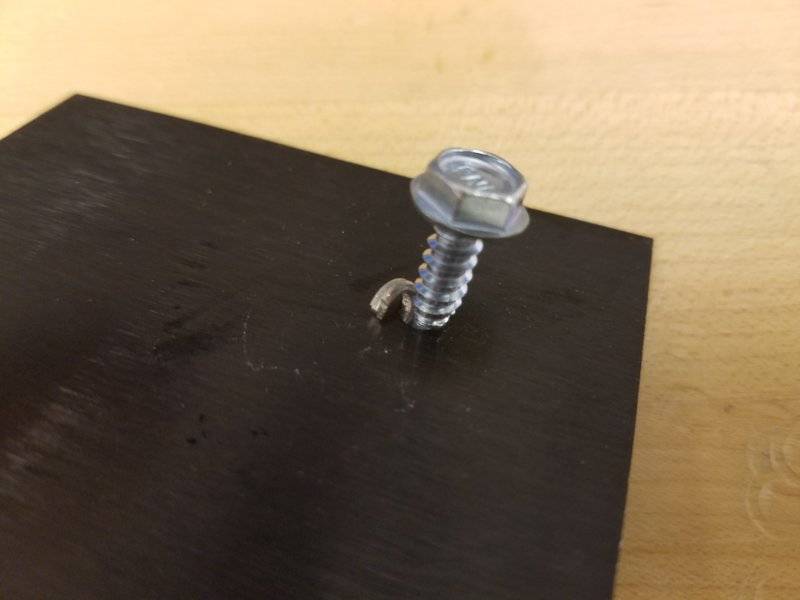

Stick a small cotter key in the hole. One leg inside, one leg outside. On the outside you can cut the leg down to 1/8" in length. The round end of the key fills part of the hole. Use the original screw.

I'm telling you guys don't mess around. For a simple hole the cotter key is foolproof. Smaller the hole, smaller the cotter key. Try it, you'll like it. Rivnuts have there place and are great as well. Just not always necessary.

I like this idea. Are you saying that you put a 90* bend on each leg, then push the round end into the hole? The 2 bent legs stick out and hold the pin from falling into the hole?
Step one, insert key. Step two, trim top side of key so it doesnt show after tightening. Step three, put the scew in.
