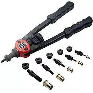

Yes, yes, yes, these work awesome and you don't need the fancy tool, they offer a cheap little tool that draws them in with a bolt. I used these on my dash and was very happy. McMaster Carr sells them pretty cheap.
I agree. Thanks dvw!I'm glad someone asked, I was having trouble picturing that myself!
But, I like to buy tools!You can set any nutsert with a bolt two washers and a nut
put the nut on then two washers thread into the nutsert
put in place hold bolt and use nut to compress the nutsert
