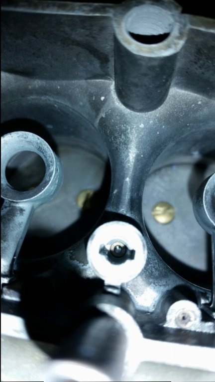

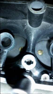

So i have had my carb inside for the last two days, watching exploaded views on holleys.
I was pretty sure i checked it already, but if you look at the picture im missing the checkvalve under the squirters on both side.
I've always thoght that especially the secondary with 40 squirt is to "bubbely", too much air in the jet.
As my primary works fine and also lacks the checkvalve i do not want to get my hopes up, but i will order the checkvalve today.
What do you guys think, can this be a part of the problem?

Doesn't the ball and weight just preven5 siphoning? I don't think it's preventing fuel from coming out.
What i understand it also prevent air from filling the pumps, delaying the shot.
Read about a guy with the same 2-3 second bog, fixed the problem when installed the pins.
Yes, it was a big difference with the pins in. Still a bog when opening secondaries but it runs much better.

40 squirt with blue cam did not work perfect, there was no stumble at all on Cruise to wot but from idle to wot i still did have moderate stumble, it was not perfect, but alot better with the pins in.
