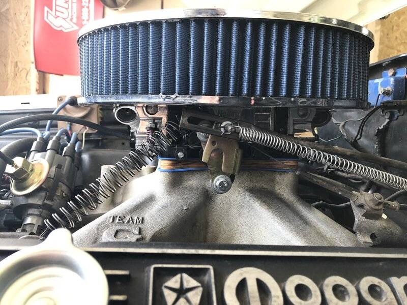

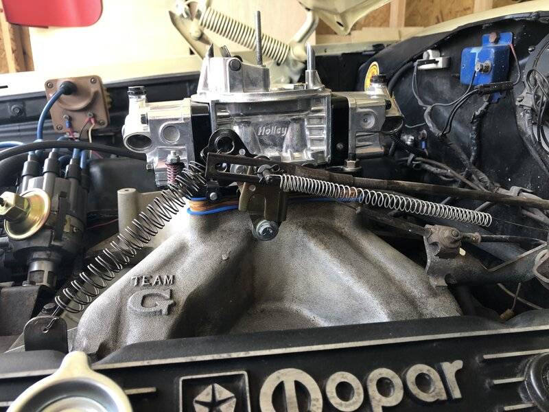

The new problem is while I was at it I put a 1/2" birch spacer between the carb and the intake and although the hood still (barely) clears I think the angle of my kickdown linkage is now too steep. I already have a Weiand Team G intake that I think is taller than the stock intake and kickdown was working fine then. But now when I tighten the air cleaner down too much the slotted linkage hits the bottom of the air cleaner and wanted to get hung up there a couple of times; if I don't torque it down too much it seems fine. I am going to attach a couple of pictures and see what people think. I was tempted to just bend the threaded throttle kickdown rod connector so it would sit more horizontally, but I'm sure that isn't the right fix. I could just take the spacer out, but it's already helping with a hot start problem so I'd rather keep it.
This was originally a 361 car, now with a 440. So I'm wondering if the kickdown linkage is even correct for a 440?
Any suggestions? I know Lokar cabled kickdown is an option, but would rather not if I don't have to. I will include a couple of photos.

I've made new brackets for accelerator cable and kickdown at the back of the intake to level out that angle some. Easy to add a little length back there.
The Team G must be about 1" taller than an OEM manifold.

I would drill a new hole for your linkage pin mabey 1/4" lower or what it takes to get the rod to clear the base.
May have to readjust trans red and throttle cable when done. Just be careful when figuring hole placement so the pull is not to close to the throttle shaft.
Do not drill and lower anything. You want to keep the linkage ratios and geometry as close to original as possible.The best way I have found to correct the linkage is this. On the main bracket an inch or so above the bolts cut it horizontal into two. Hold the cable attachment part it the approximate position it would be from the factory. Measure to the bolted part and make a piece up and weld it up. Now the throttle cable part will be correct. Next cut the rod that goes to the transmission just below the top pivot an it is fairly straight. Again mock it up and figure the extension rod length. The piece you need will be about the same as the bracket piece you previously used. Weld it to the old rod and all you will just have to do is make minor adjustments. The ratios and geometry will be the same. You also need to correct your return springs with a taller bracket. Once ground and painted it will look close to stock.
