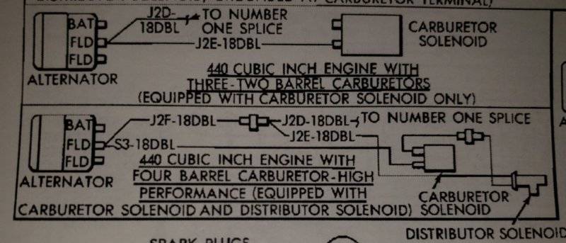

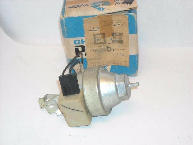

It can also be hooked up through the distributor vacuum advance stupid system. The vac advance goes five degrees advanced and activates the solenoid. If you have that advance on the car you will definitely know it.

To Halifaxops.... the distributor solenoid shown in your posting RETARDS the static timing approximately 5 degrees thru the insulated connection on the carb's hot idle screw....just thought you might like to know.....BR
